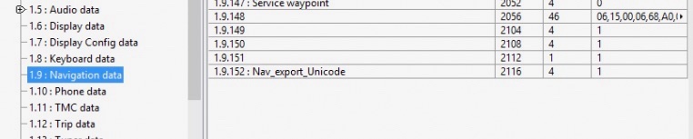

Does anyone know what the sub-item "Nav_export_Unicode" in the menu item "Navigation Data" means? And which values are allowed there? Maybe that will solve my problem

Where are you getting this from - there is nothing official regarding these values and no settings in the diagnostic tool that can be used to change the internal data of the Head Unit.

I‘ve read out the userconfig with Mirascripts and searched for possible matching items ...GiveMeABreak wrote: 17 Sep 2021, 14:04 Where are you getting this from - there is nothing official regarding these values and no settings in the diagnostic tool that can be used to change the internal data of the Head Unit.
