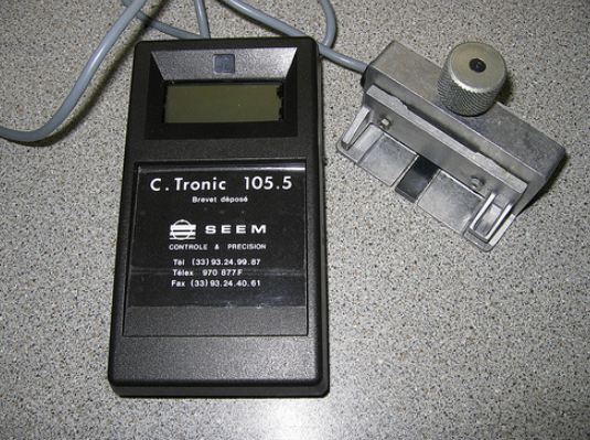

On some of these 1.8s special tensioning equipment is required when replacing the belt. I think it's referred to as a 'SEEM C.TRONIC 105.5'

You are right but this equipment is used for the early versions which were equipped with the manual tensioner.
My car is the latest version with the automatic spring loaded tensioner and doesn't need any special tools.
