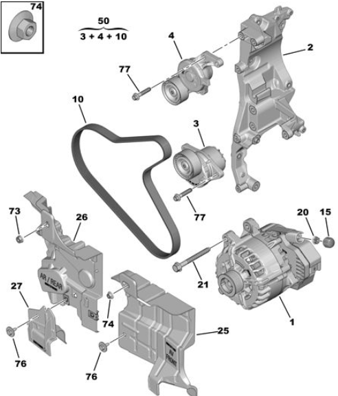

So this has 2 dynamic tensioner rollers (3) & (4) and has a reversible alternator system.
At least this one comes with a belt roller kit, item (50), which includes both the tensioners and the belt, which has already been superseded with a later part (1616876980) which is £205.92 inc. 20% UK VAT.
Nearly had a feint when I saw 'STT 6 speed....' which I started to think you had a one of those Carlos Fandango semi-auto piloted boxes
, until I read on and it said AM6
So you have a Dec 2015 build DS4 Don - your config says it has been personalised - and doesn't indicate SCR system - but it is Euro 6.1 standard, so I'm guessing it does have the SCR system fitted?
Regarding the alternator setup - unfortunately this is on the DW10FC engine and has been modified from earlier systems, so the tensioners are all different and I don't have the repair guide for this one.
But as for parts:

Tensioner 4 is the knackered part which I can source in UK for 34 pounds. Getting the old part out of said car is the hard bit. Service Citroen used to have an excellent service for repair processes but some bright spark with PSA closed it down. I cannot imagine what was the reason.

No worries - just be aware that item (4) has already also been superseded with a new part (1616876780) £188.58 over here.
So whether they had issues with the earlier part (1611608580) I can't say, but the other tensioner (3) has retained its original part number.
