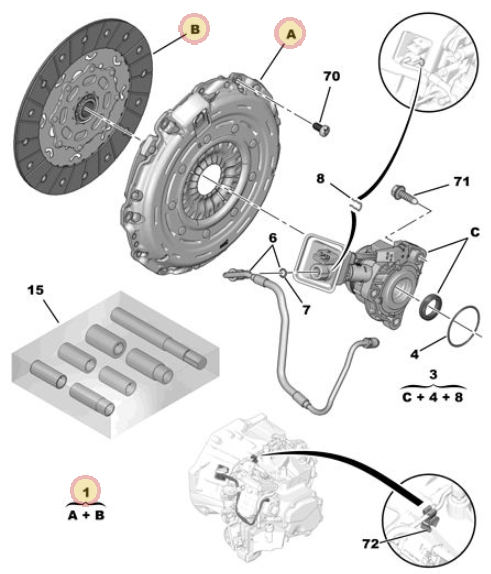

Sorry to be a pain, but could you pull up the part numbers from PSA system for anything that could be changed in that thing, please.
Personally I think that the clutch is slipping and needs to be changed. Well it has over 128k so it will def need my attention. Also where could I get some diagrams? Really want to learn more about it.
Thanks
Jan

This is the clutch kit for your vehicle:
Part: 2052Z1 for Peugeot original price £424.33
Part: 2051Z2 for Peugeot Exchange Kit, price £235.01
All prices from Peugeot as of today.
I wouldn't touch anything to do with the hydraulic actuator system! The system is pressurised and must be depressurised to check and fill. This should not be necessary under normal operation. It also uses special hydraulic oil.

Great, Thank you Marc
Just checked the Valeo Kit2p is the 2052-Z1 and its £130 in Autodoc. Well thats just a clutch plate and pressure plate.
Should I go for the whole thing with central slave cylinder, with clutch pressure plate, with clutch plate, with sensor?

Re: Gearbox Info
