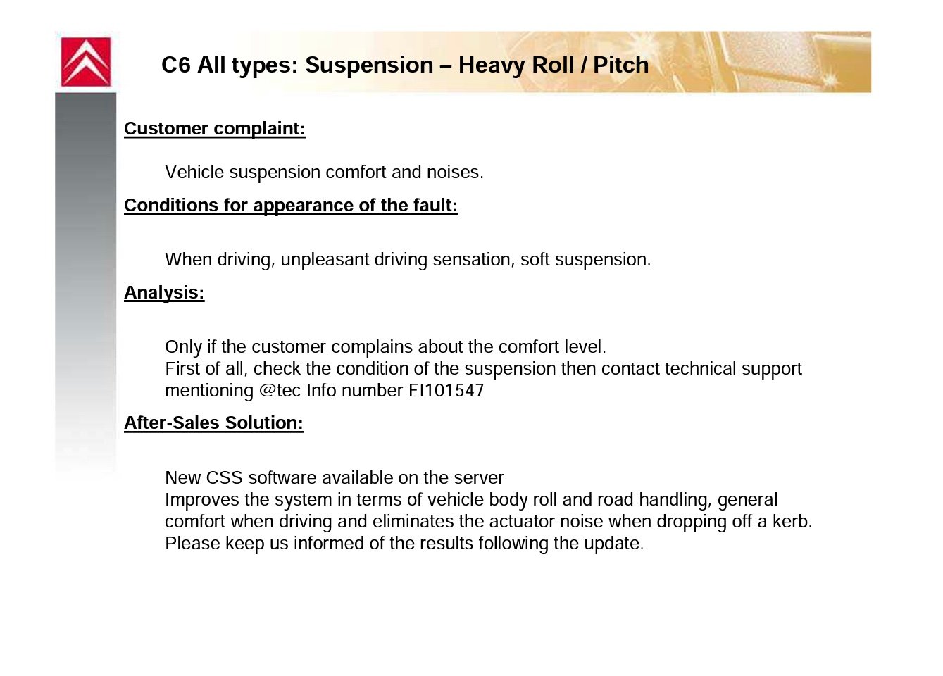

For example, are there any more like this one for the suspension pitching (c/oC6owners)

I don't have your VIN James - if you've previously PM'd me with it - it will have gone as my inbox gets full quite quickly, so I regularly have to clear out messages.
There will be differences between a recall of course which are generally safety-related where customers can be notified (assuming that Citroen has your details) or there can be after-sales campaigns for action the technical department need to take if the VIN is flagged up when the vehicle is booked in at a dealership for any other reason. Normally these would be picked up at a service for example.
Additional to that, there are Technical Service Bulletins are issued for accumulated known problems over time for certain issues on vehicles. These are very vehicle-specific. They can be checked against a customer complaint, or when specific symptoms are presented, or if specific fault codes are returned on a diagnostic scan that will detail any procedure to be undertaken or any warranty claim process if applicable for a faulty part.
As you can see from the one you quoted, that concerns the CSS suspension computer (which is only fitted to C5 and C6 V6-engined vehicles). Further it is only the V6 C6 vehicles with AMVAR, which have dampening actuators fitted on each corner strut. V6 models have 2 suspension ECUs, one built into the BHI and a separate one (CSS) on these models. You can also see that they are told only to apply the software update if "the customer complains about the comfort level".

The suspension does the pitching like my previous one didn’t so maybe it is due the upgrade. I don’t mind paying them… I imagine the “only if the customer complains” part is to keep costs and work down during the warranty period.
My C6 is a V6 petrol so will have all the AMVAR magic on it.
The reason I’ve gone down this route is basically my last step before I replace the sphere, but that can wait until next year. The car was once on a pretty bad road and pit itself in to hard mode and it was absolutely awful to be in— proper bouncing around! Therefore maybe the update is necessary

James, I'd get all your spheres pressure tested before worrying about software updates.
In my experience a C6 with spheres at reduced pressures will exhibit the symptoms you described & the software update won’t counteract that.
The early C6, of which yours is one, drove as though the rear of the car was too soft & the rear of the car would bob up/down on bumpy/undulating roads, particularly if carrying passengers in the rear.
The software update changed the damper valve settings, effectively eliminating the softest settings. Remember there are 16 different damper valve settings for each corner sphere.
I tend to put the suspension into sport mode when carrying luggage & rear passengers, this stops the car bobbing up/down as much.
If your car seems really stiff in sport mode or when cornering hard (when the central spheres are most likely to be switched out of the hydraulic circuit), this suggests the outer spheres (one on each wheel) are low on pressure.

Good point Shaun. I’m not far from Pleiades and they checked and re-charged the spheres on the last C6 I had.
Other than this one episode where it went rock hard on a pretty bumpy road, I’d say mine has good manners until pushed.
Good to know the detail of the upgrade which removed the softest settings. I will now go down the sphere route then.
