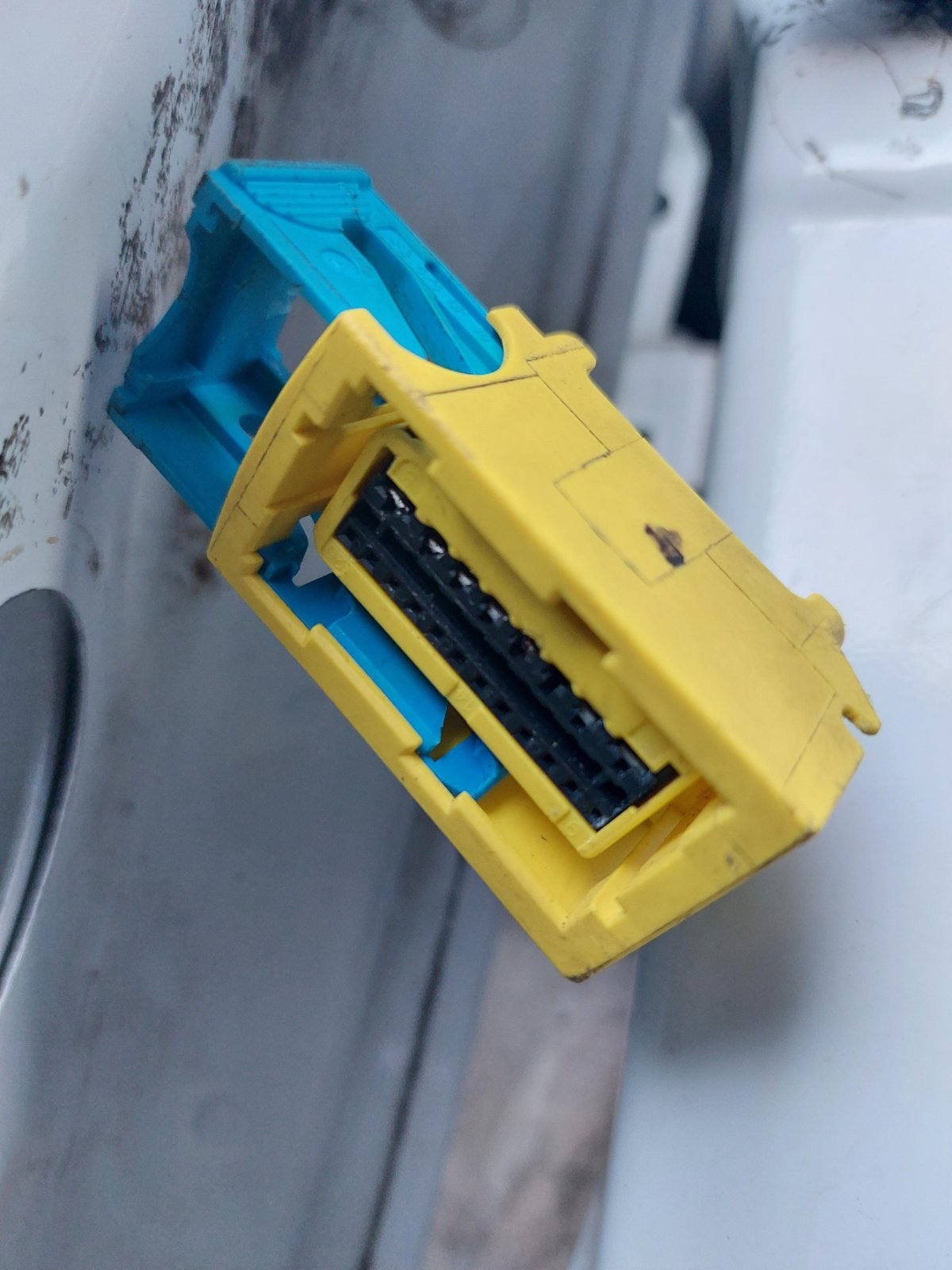

Thanks for that. Looks like I've got a couple of bad connections in the connector block between the main harness and the door harness. To test I've disconnected the door harness and run two wires from the main harness block straight to the window motor. Now when I operate the switch and use a circuit tester it lights up for each test wire connected to the motor . The motor though is not working - should it work like this with the door harness disconnected? Grab a copy of the haynes manual today and it looks like the motor is ground at the switch.

Just a random guess but if you have the option to operate the passenger window from the drivers side then it could be a break in the wiring on the drivers side which i think would be the main control point ?
So if not connected between the 2 sides then maybe the passenger side switch is not getting an input to operate, you did say that the switch itself works when putting into the drivers side window and the passenger side motor works with direct power ( not via the plug/wiring )
Like i said just a random guess
