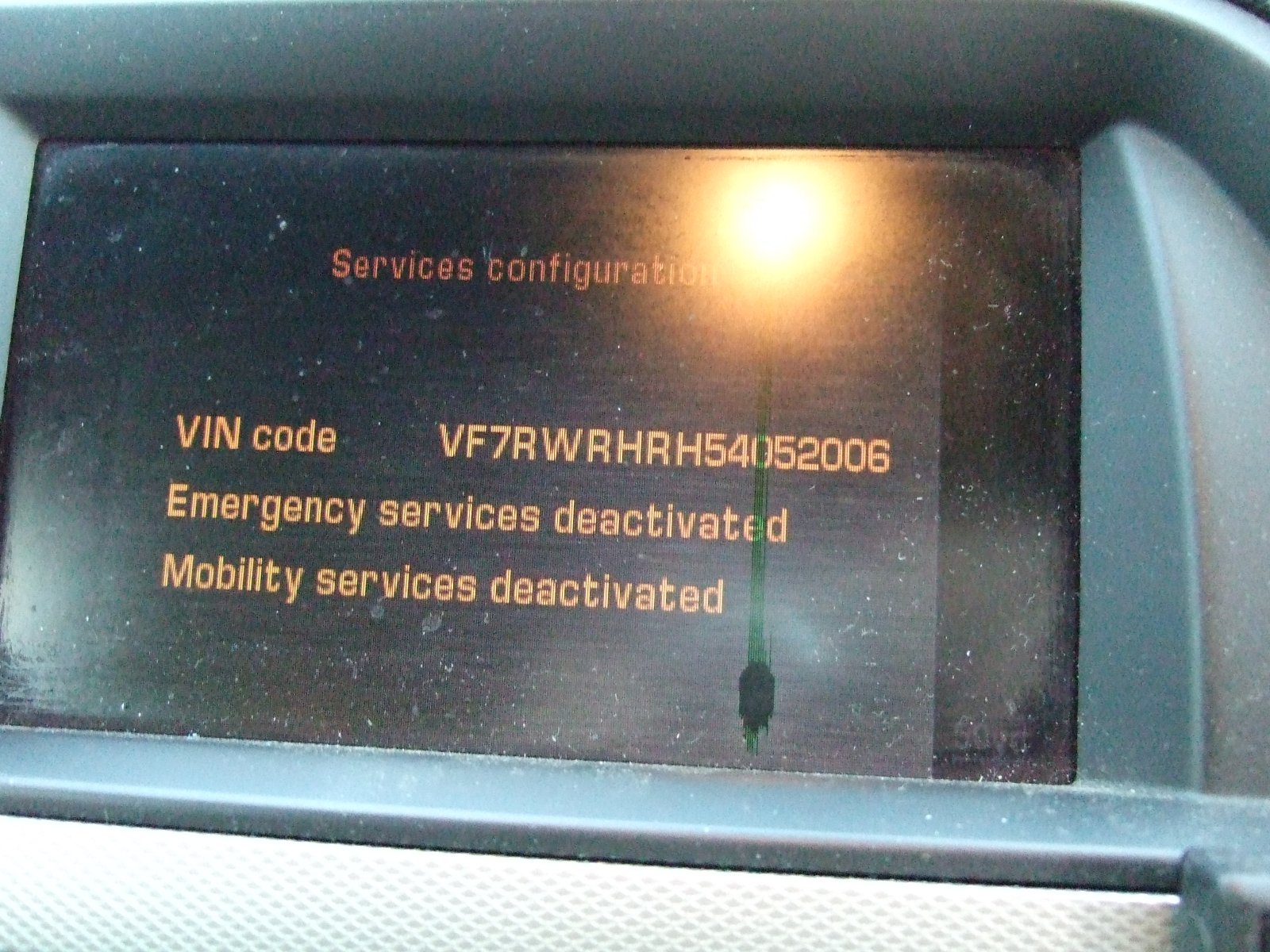

Re: X7 satnav fault. Can I swap it for a used one?
You can see the gravy stain too.

Ok, so that's not the menu for the software version Peter - you've gone into services configuration (which shows that your emergency services options are not active - as in when pressing the emergency call button).
I think you need to hold down the MENU button for up to 10 seconds until you get the system menu that shows the software version.

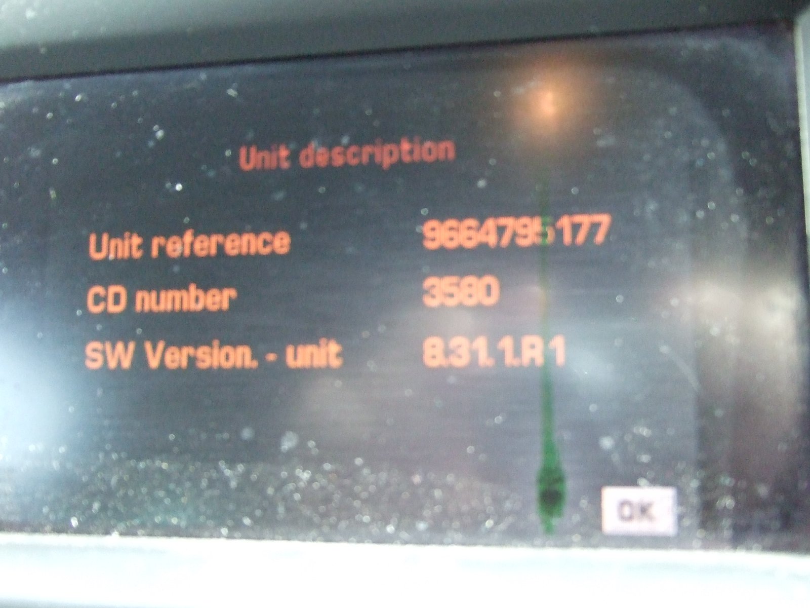

This is the only other one I can find Marc, apologies for the picture quality but it only stays on the screen for a few seconds.

That's the one Peter.
So this shows you already have the latest and last firmware version available installed Peter (V8.31). So whether re-applying the existing firmware will re-write any corrupt files is a chance you may want to consider. The screen does looks like some of the liquid crystal has leaked out, but the calculations for the navigation are all done on the Head Unit. So you likely have 2 separate issues here.
