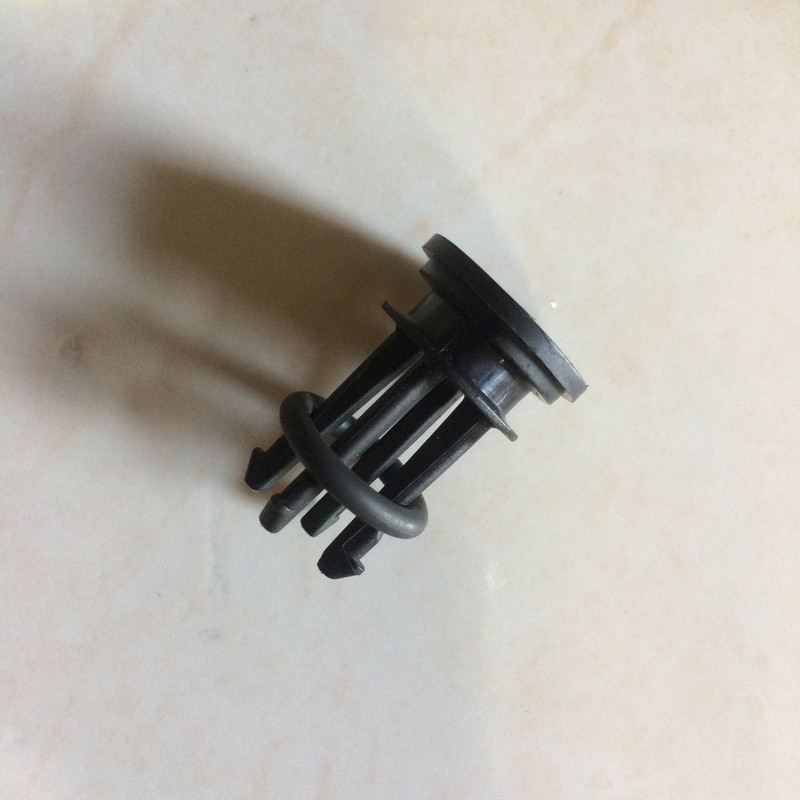

what is the size of this oring? the old one is squished and brakes!

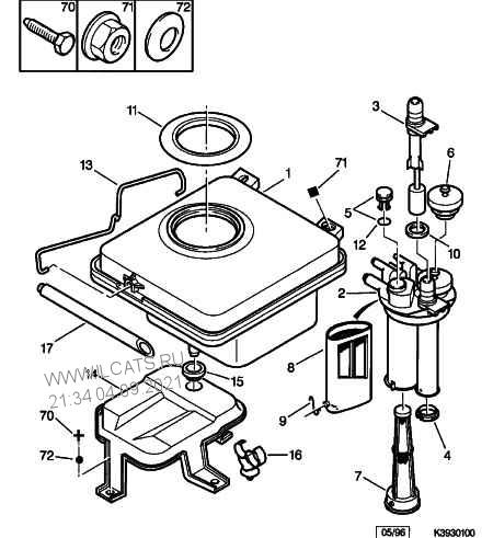

number 12 on pic:
x 1746
Re: Xantia reservoir O-Ring size
11.2 x 2.7 mm

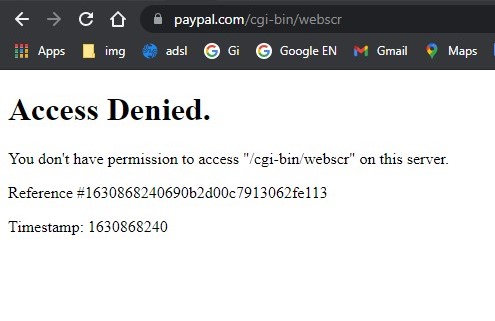

thats what happend.
sorry i cant cos we dont have access to paypal and...
