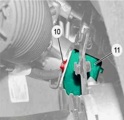

HOWEVER, it does not raise / lower the front. I have changed the height sensor on the front.
Anyone there that a photo how the connection rod (from the sensor to the sway bar) should sit (in case I have put mine wrong) or should some sort of calibration be done after sensor change?

This is the correct removal / refitting procedure that may help you cross reference.
Fine adjustments are carried out using the standard height checking and measurement procedure - but only fine adjustments.
Unclip:
  • The connector (at "c")
  • The connector (at "d") (according to equipment)
  • The connector (at "e")
Uncouple the rod (8) from the lever (9).
Remove the bolt (10).
Remove the front height sensor (11) through the wheel arch.
Refitting
Peg: The height sensor (at "g") using a TORX socket wrench 25.
Refit the front to fight sensor (11) to the support (12).
N.B. : Position the lug "f" on the support (12).
Hold the height sensor (11) in position.
Refit bolt (10). Tighten to 0,4 ± 0,1 daN.m.
Remove the setting rod from the height sensor.
Couple the rod (1) on the lever (2).
Clip:
    Connect:
    • The connector (at "b") (according to equipment)
    • The connector (at "a")
    Refit:
    • The yokes (6)
    • The bolts (7) Tighten to 10 ± 1 daN.m
    • The bolts (5) Tighten to 14 ± 1,4 daN.m
    • The clip (4)
    • The nut (3) Tighten to 2,5 ± 0,3 daN.m
    • The (2) bolt Tighten to 6 ± 0,6 daN.m
    Pull the lifting tool from under the front subframe.
    Refit the front wheels.
    Tighten the wheel bolts.
    Return the vehicle to its wheels.

Thanks Marc. I think that I have to try again. If I remember correct, my bone is conneced so the sensor 'on the top'.
RigStodder
Posts: 10
Joined: 22 Aug 2018, 14:09
Location: Denmark
My Cars: Citroen C5 Tourer from 2009 with 300k km.
Former cars:
C5 X7 HDi 140 Tourer non-hydraulic, 3xXantia, Suzuki Gran Vitara XL7 V6, 2xSkoda Favorit, Mazda 1300 St., VW Golf II,
x 1
Re: C5 X7 'Suspension Fault'.
Post by RigStodder »
Refitted the rod and the car raises and lowers again at both ends :-D
Thanks for the help =D>
