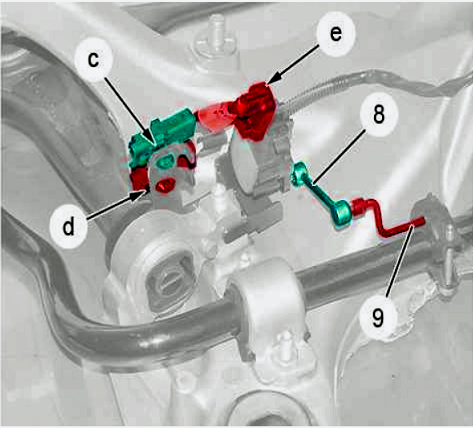

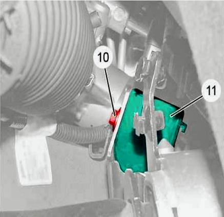

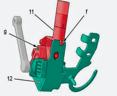

OK. The error has been found and removed. It was the control for the hydraulic pump that had lost its settings?!? A manual configuration and it raises and lowers again.
HOWEVER, it does not raise / lower the front. I have changed the height sensor on the front.
Anyone there that a photo how the connection rod (from the sensor to the sway bar) should sit (in case I have put mine wrong) or should some sort of calibration be done after sensor change?
- x 6955
Re: C5 X7 'Suspension Fault'.
This is the correct removal / refitting procedure that may help you cross reference.
Fine adjustments are carried out using the standard height checking and measurement procedure - but only fine adjustments.
Unclip:
Remove the bolt (10).
Remove the front height sensor (11) through the wheel arch.
Refitting
Peg: The height sensor (at "g") using a TORX socket wrench 25.
Refit the front to fight sensor (11) to the support (12).
N.B. : Position the lug "f" on the support (12).
Hold the height sensor (11) in position.
Refit bolt (10). Tighten to 0,4 ± 0,1 daN.m.
Remove the setting rod from the height sensor.
Couple the rod (1) on the lever (2).
Clip:
Unclip:
- The connector (at "c")
- The connector (at "d") (according to equipment)
- The connector (at "e")
Refitting
Clip:
Connect:- The connector (at "b") (according to equipment)
- The connector (at "a")
- The yokes (6)
- The bolts (7) Tighten to 10 ± 1 daN.m
- The bolts (5) Tighten to 14 ± 1,4 daN.m
- The clip (4)
- The nut (3) Tighten to 2,5 ± 0,3 daN.m
- The (2) bolt Tighten to 6 ± 0,6 daN.m
Refit the front wheels.
Tighten the wheel bolts.
Return the vehicle to its wheels.
