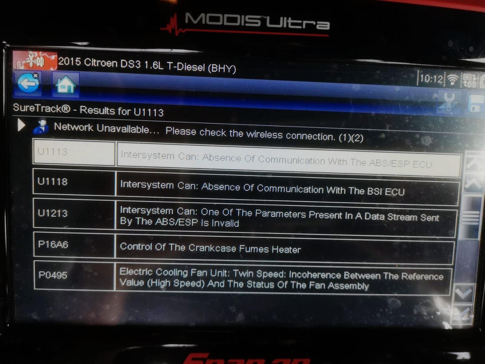

my wife has a ds3 1.6 diesel. the car drives fine but won't rev over a certain amount (so mainly this is an issue for overtaking) on the computer screen it keeps flashing up with something to do with fault , take it to a garage . she has to just click the screen every time to dismiss it. we had a local garage plug it in and ran diagnostics on it. The mechanic was unsure. The service light on the dash is also illiminated. Could the computer be at fault or is one of these codes causing it. The picture attached is the faults. There is also sometimes an issue where we fill the car with ad blue and sometimes it still thinks it requires some more ad blue, but not sure if this is related? any help is much appreciated.
ds3 won't rev much above 2-3k revs - fault codes

I would say that the top three codes do look rather 'interesting'.

Not sure any of those codes would result in limp mode, might need to re-scan it with an alternative tool! Does the light come on when you accelerate? It could be the fuel filter if it's not been changed, although these have a low pressure pump, so not that likely.
The ad blue thing might be the harbinger of something expensive unfortunately...the early ones have trouble with the adblue leaking into the electronics and wrecking them, trouble is it's only available as a complete unit with the tank costing about a grand!
