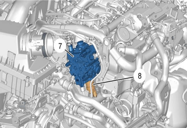

My amature guess is that it either is the control module for the injectors or throttle body that is acting up. Logically the throttle body is the first to check since it decide how long time the injectors should be open.
Throttle body action should be possible to check with an oscilloscope, and that goes for the injectors as well but as I am a beginner in this area, I don't know where to best attach the probes. Lexia seems to have limitations in this area, especially when it comes to save and replay but as I am a beginner, I might not use it to its full potential.

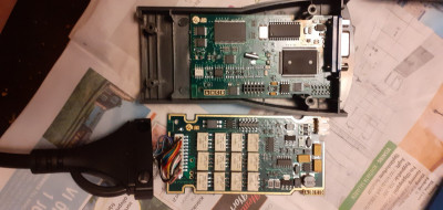

This is what I got for the interface. The DiagBox program I am running on Win 7, on a Asus computer with a brand new SolidStateDrive. Computer bought purposely and dedicated to only run Diagbox, nothing else on it and no connection with internet.

Ok, so that kit is missing a lot of hardware - I can see straight away!
See my post here for the obvious ones:
