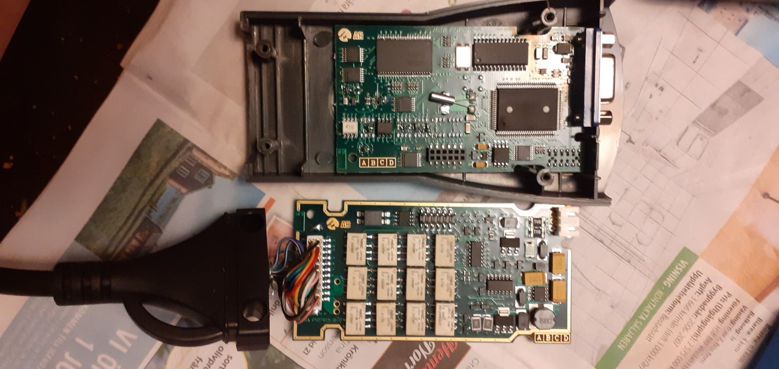

This is what I got for the interface. The DiagBox program I am running on Win 7, on a Asus computer with a brand new SolidStateDrive. Computer bought purposely and dedicated to only run Diagbox, nothing else on it and no connection with internet.

Ok, so that kit is missing a lot of hardware - I can see straight away!
