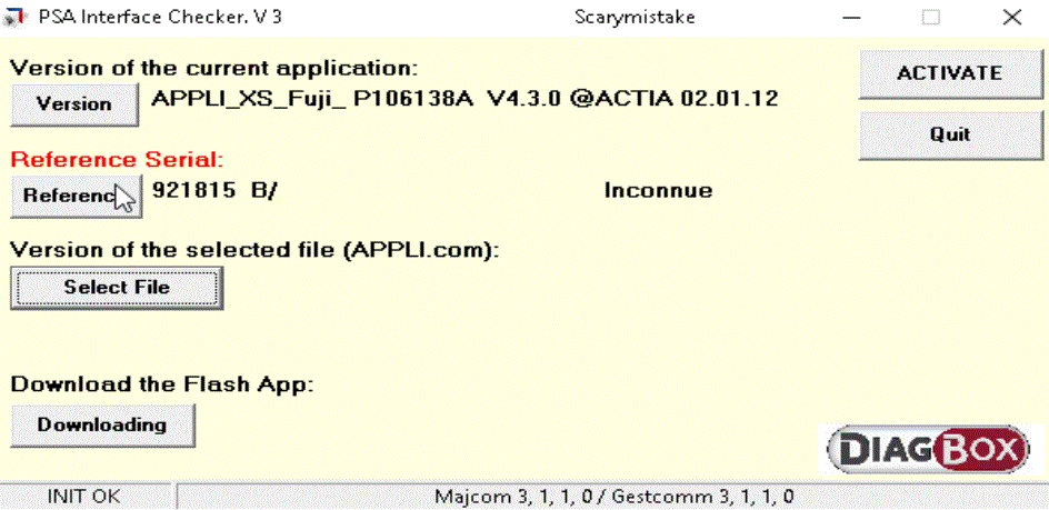

Looking at the VCI circuit board it looks like its made to be fully chipped, is that something that can be done DIY?

Is that only for fully chipped c version, or will my b version support diagbox upto v7.56, it looks like it has 4.3.0 firmware?This intentionally only covers versions from 7.02 to 7.76:
DiagBox v7.02 needs 4.3.0
DiagBox v7.57 needs 4.3.2
DiagBox v7.58 needs 4.3.2
DiagBox v7.62 needs 4.3.3
DiagBox v7.66 needs 4.3.3
DiagBox v7.74 needs 4.3.3
DiagBox v7.76 needs 4.3.3

The missing hardware can be Optocouplers (or Opto-isolators), resistors and some other hardware / chips, so regardless of the firmware you put on, if it hasn't got all the electronics, it won't work and you probably find it won't communicate with some or all of the ECUs of later multiplexed vehicles.
Those are just the firmware versions that Diagbox V7.** automatically installs tot he VCI hardware according to the update you are installing.
There's no exact answer because it depends on your vehicle, the year, the type of multiplexing used and of course the BSI and how new the other ECUs are on the vehicle. That's why a lot of revision B units had to stick to lower software versions like V7.02 - and for some older cars, Diagbox V5
