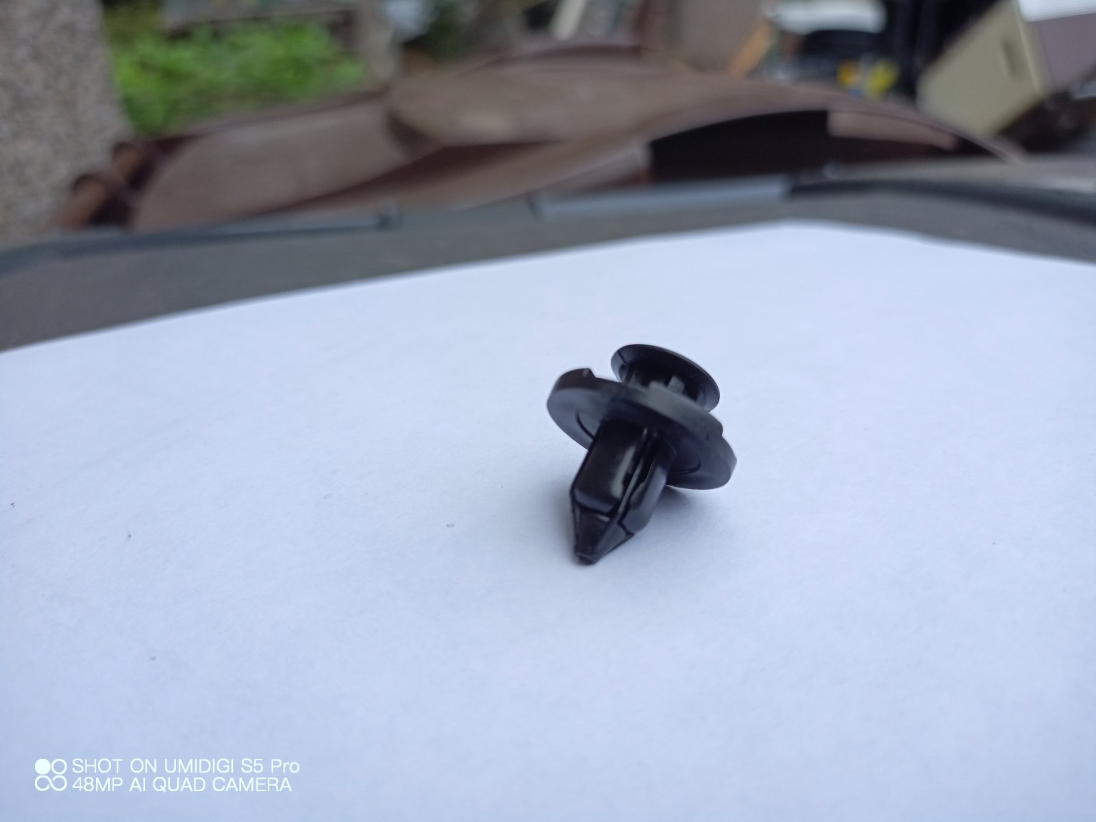

Thought as much. Just been to my auto parts store for new plastic clips as I managed to break a couple of the little buggers. (The guy on YouTube popped his out so easy. You would have thought he had smaller clips in.) Also bought a cheap pop riveter as I will hardly ever use it again and didn't think it was worthwhile buying an expensive one. Lets hope it doesn't bite me.
