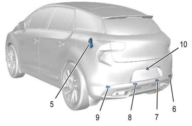

Re: Parking sensor fault DS5
You can't reset the ECU, but I would recommend a diagnostic with Diagbox to find out what fault code is being throw up.
The Parking Assistance ECU is stored in the rear left side of the boot:- item (5).
