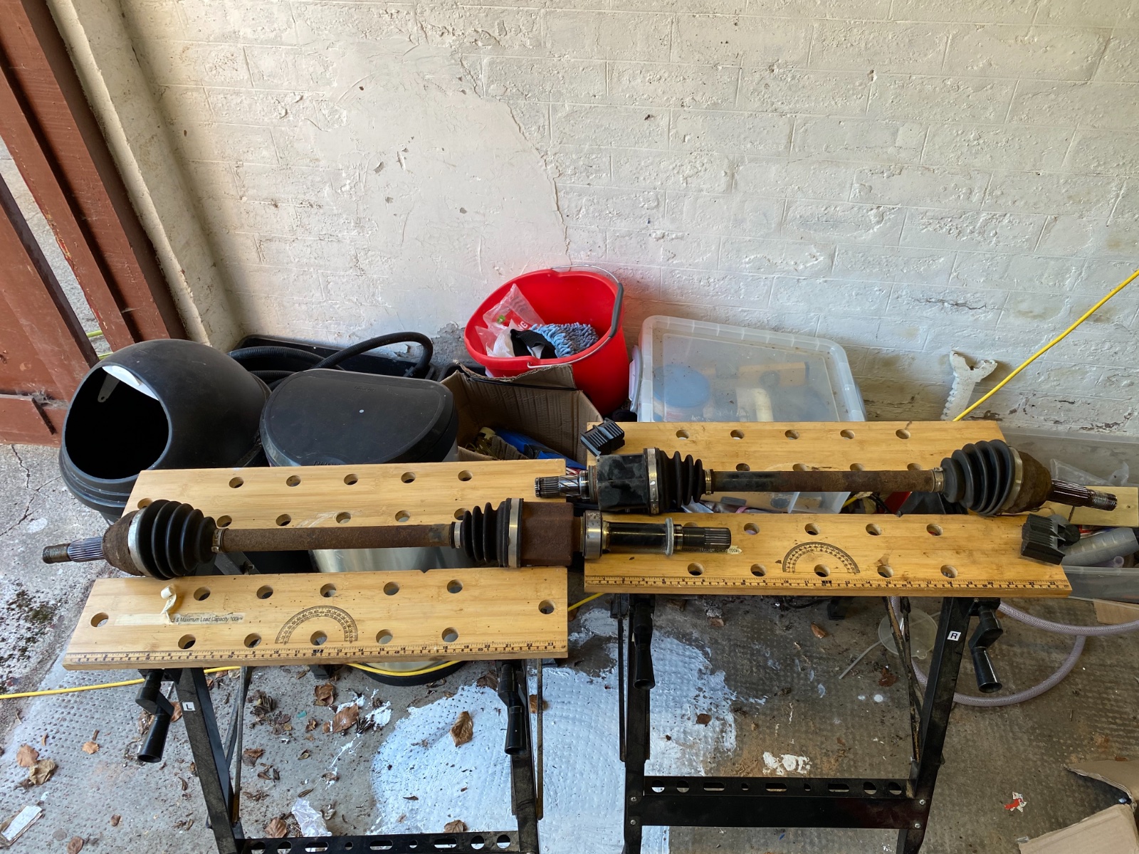

Well it’s taken me about 6 hours struggling in near 30C heat (mainly the lower ball joints were giving me grief) but I finally have both driveshafts out
I’ve just got an alert that the driveshaft seals coming from Latvia should be here on Monday.
So now I have a choice - continue work over the next few days to swap the gearbox then fit the seals in-situ before reinstalling the driveshafts, or take a break until the seals arrive and fit them to the gearbox on the bench…
I also need to get new bolts/nuts for the lower ball joint as the thread end of the bolt is well and truly mashed from having to hammer it out!
Might have to go to Nissan for that one as I don’t see them online…

No, I gave your suggestion due consideration but after looking at the bolts between the strut and hub - which have very long exposed rusty threads to wind the nut off I decided the ball joint would probably be less of a hassle. Maybe that wasn't the case in the final analysis but I did not like the look of trying to wind the nuts off a couple of inches of very rusty exposed thread on the strut bolts, nor affecting the camber when I bolted it back together.NewcastleFalcon wrote: 21 Jul 2021, 20:42Mandrake wrote: 21 Jul 2021, 19:18 (mainly the lower ball joints were giving me grief)
I also need to get new bolts/nuts for the lower ball joint as the thread end of the bolt is well and truly mashed from having to hammer it out! Might have to go to Nissan for that one as I don’t see them online…One suggestion which fell on stony groundNewcastleFalcon wrote: 20 Jul 2021, 08:36 ... undoing the 2 easily got at Strut mounting bolts from the hub carrier allows the hub to be swung out to remove the driveshaft from the hub. May be an easier route.Its the Scotty Kilmer way too and may have proved easier than the ball joint route.
The driveshafts came out easily once I had the hubs moved far enough out - I used the same method in the video Richard posted - just put a cold chisel between the driveshaft joint and the gearbox on the left hand side and give it a sideways tap at the bottom of the chisel to push it out.Did the driveshafts just pull out/pry easily, together with the snap ring intact and no sign of chewing up of the splines on the end of the driveshafts or the female end at the gearbox.![]()
Only the short left side driveshaft has a snap ring on the gearbox spline, the right side driveshaft has no snap ring and relies on the bracket for the intermediate bearing to locate the lateral location of the driveshaft in the gearbox. The intermediate bearing sits in the bracket and a small plate is bolted over it to keep it from pulling out. So after removing that plate you can literally just pull the spline out of the gearbox with no resistance.
The splines all look fine, intermediate bearing seems smooth, CV joint and hub mating faces seem fine (although not very well greased) and the joints also seem fine. So apart from the usual surface rust on the shaft everything seems fine there.
