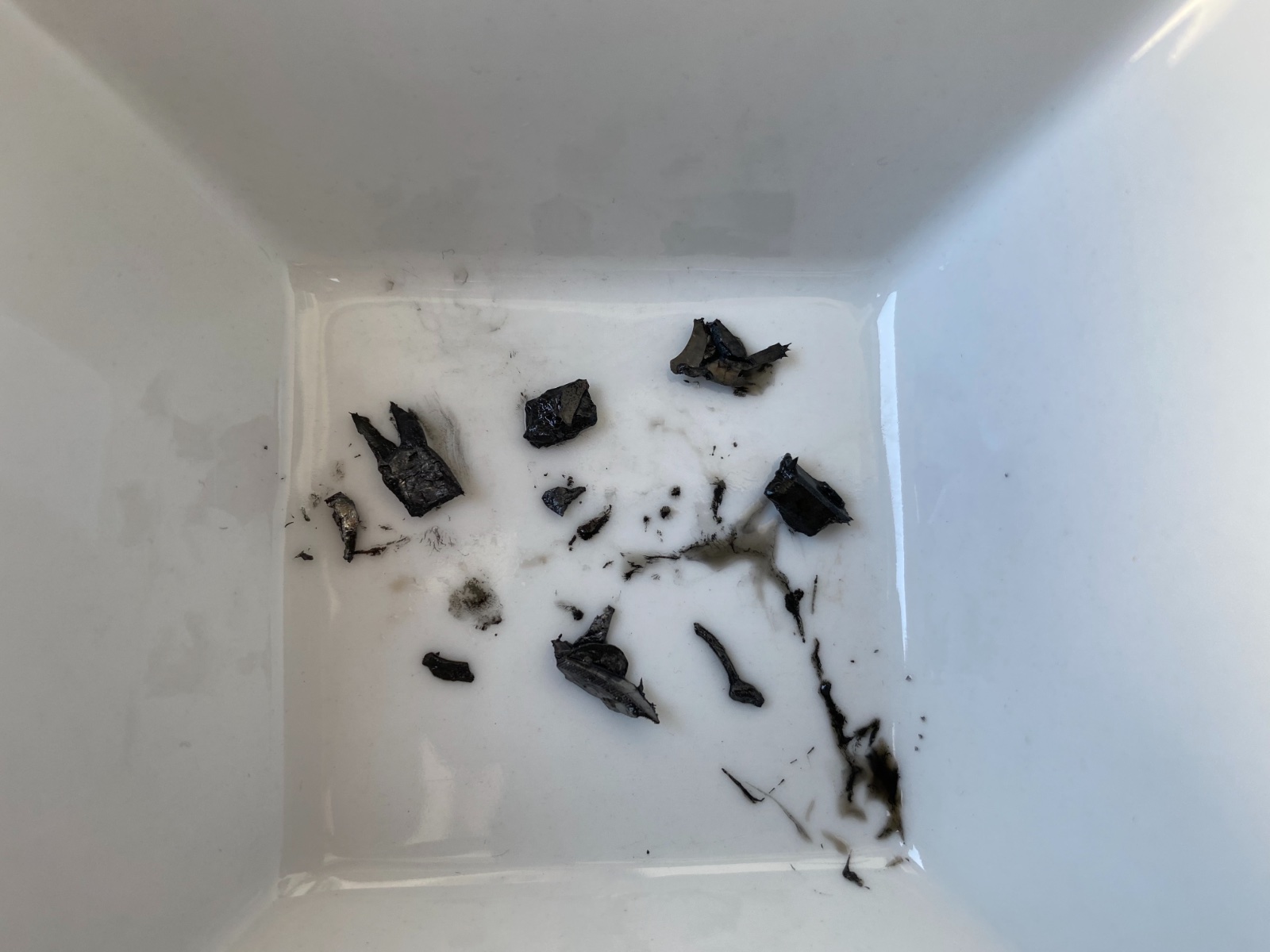

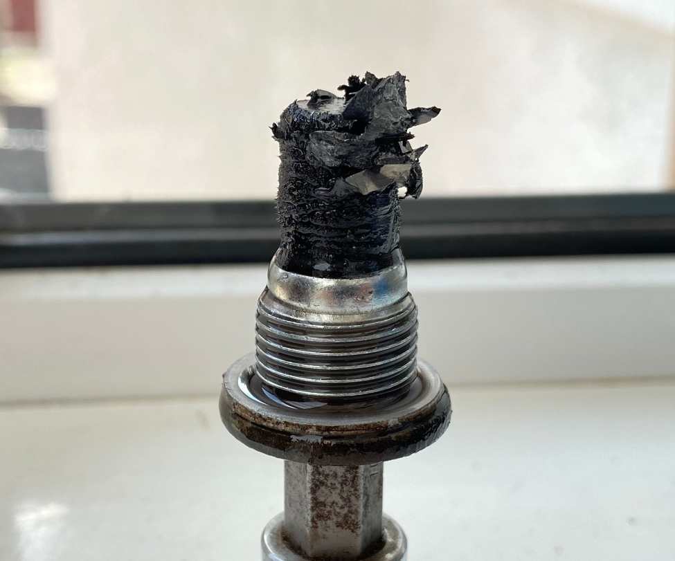

Draining the gearbox before removing the driveshafts and found this on the drain plug. Yeah, not very healthy looking...
Multiple large curved sharp metal shards around 8mm long by 3mm diameter. That's not going to buff out with an oil change....
Looks like I made the right call on the gearbox. Now to see if I can get the driveshafts out.

- Posts: 26424
Re: Simon's new Xantia V6 and Leaf blog
When you get round to giving the old gearbox a post-mortem, the cause should be easy enough to spot on that evidenceMandrake wrote: 21 Jul 2021, 13:18 Multiple large curved sharp metal shards around 8mm long by 3mm diameter. That's not going to buff out with an oil change....
Thank goodness for the plug magnet!
You absolutely made the right call, Simon.

Looks a lot like drilling swarf ??white exec wrote: 21 Jul 2021, 19:09 Thank goodness for the plug magnet!

That must have stung on the way out!!

I have to agree there Simon, it posts the question: Is that the result of the fault you are yet to identify or is it the cause? Could it possibly be a manufacturing cock-up which left the swarf in the bottom of the box from new and it has taken this amount of time to cause the actual failure you have still to identify? We look forward to looking inside!!Mandrake wrote: 21 Jul 2021, 19:14Looks a lot like drilling swarf ??white exec wrote: 21 Jul 2021, 19:09 Thank goodness for the plug magnet!
