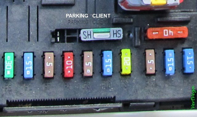

The idea behind the 'Shunt Fuse' is very simple. When it is in the 'showroom' position various items are disabled, to preserve battery life (and because those items are not 'needed'). As it is being prepared for its new owner the 'shunt fuse' is moved into the 'working' position, so all items are now working.
(PS I don't know the correct terms for the 'shunt fuse' positions, so I used terms that I hope are self explanatory).

On the BSI it will look something like this, there are 2 positions Park & Client.
Yours should be in the 'client' position.
Does the alarm trigger immediately after locking?
