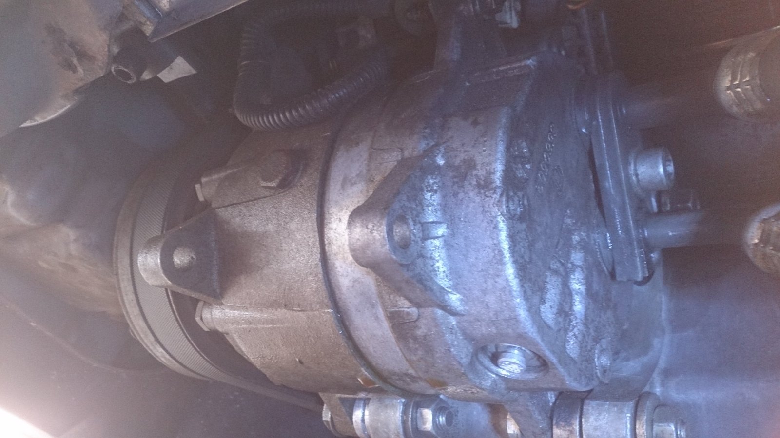

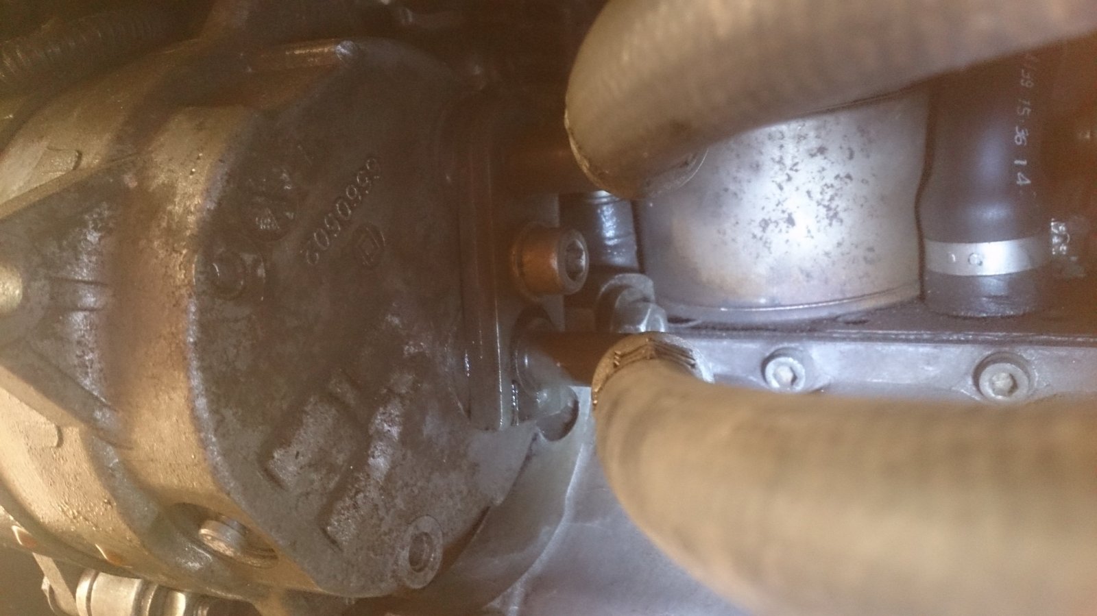

Hi, I'd need some help please to identify correctly the compressor for the A/C of my Peugeot 406 2.1TD Break from 11/1997, as it is leaking and because of the impossible quote the specialized garage made, I'm going to order myself a new compatible compressor and my mechanic who I usually go to will install it, and only then I will go to the A/C specialist to have it vacuumed and charged with gas. Only problem seems to be to identify correctly, while searching on the net I found two different types, not sure if that's correct. But then these seem to be suitable for quite a lot of cars of the PSA group, not only the Peugeot 406, so maybe it won't be that tough. Today I managed to shoot some photos of the installed compressor (as the system shortly works fine after charging and before the gas escapes reaching low point, I assume it's the correct model). Here they go. I was able to identify a part number (6560502). Googling it up looks like it's a Delphi. Can someone confirm this? Also, what would be the easiest way to obtain the correct OEM number from here? Or can I try to search for equivalents for this number from Delphi? As I'm not sure if I can trust the "vehicle compatibility" tools from part sellers... often they are not very precise... Thanks for any hints on this.

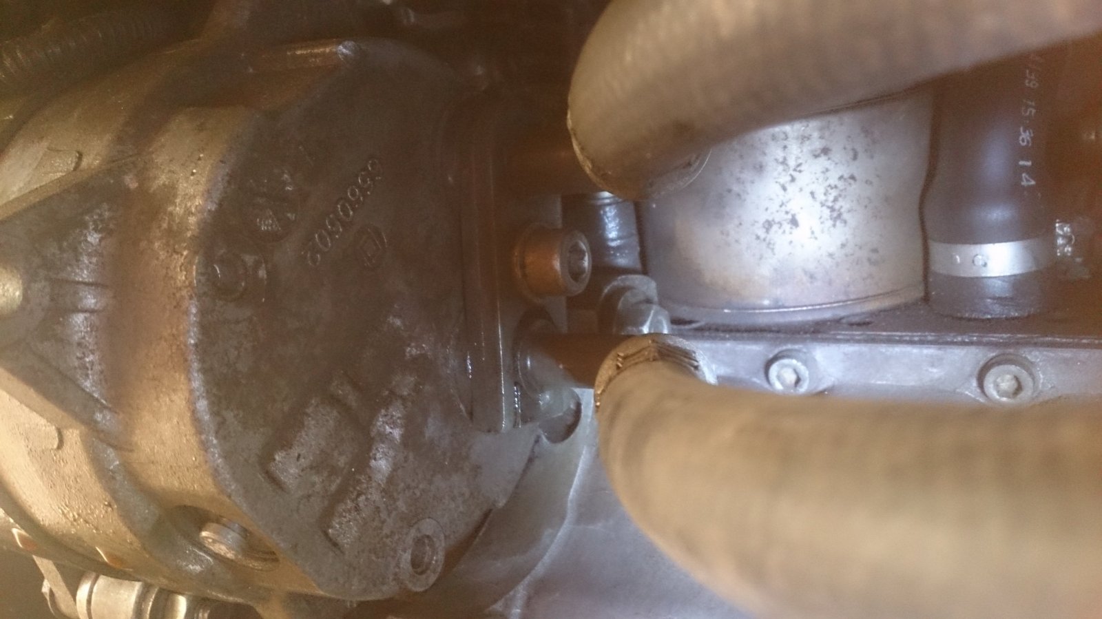

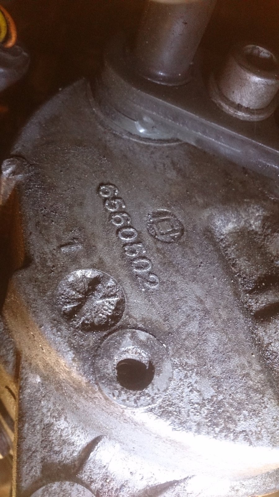

After a second good luck, it seems this number 6560502 is already the OEM number??? Now I'm confused.
- x 6946
Re: Peugeot 406 - Help needed identifying correct compressor for A/C
That's not an OEM number, but for official parts info, we do ask members for a £10 Forum donation - as we are charged for this info. But it will entitle you to ask for live part numbers and parts diagrams for up to 2 years. Details below: If you want to go ahead and upgrade your membership links are below, then just pop your VIN up here.

Regarding the problem, this is exactly what I did, I went back to that garage (who specialize on A/C repair) and they did have a check of the underside where the oil drops are and also close to the pulley of the compressor, noting the oil but also using a UV light and confirming that it's the compressor that's leaking. I'm aware that the system can very well have an additional leak, but first things first - if the compressor is leaking, I know that it can be repaired, but honestly, I can't find anyone willing to do that, at least not here. And I'm in no position to do this myself, for what I could find out on the internet, even a simple repair like the shaft seal implies normally the use of special tools and it may be difficult to get the correct seals. Also, the compressor might very well have further seals damaged or other problems, so it's going to substituted. Then system will be flushed and properly filled with gas and oil by that garage, then hopefully it will work fine and hold the gas. If it then still loses the gas, then there's another leak and that can be sorted, too. Would be real bad luck if it had a second leak in some other component that's difficult to access or expensive, so for now I'm simply focussing on what's pretty obvious - the compressor is leaking, so my best option here and right now, is to substitute it.

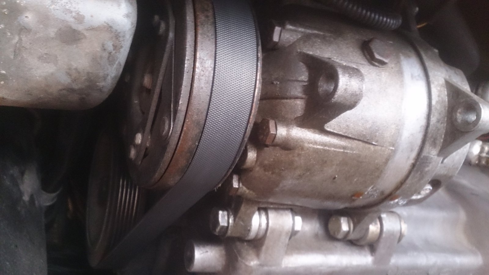

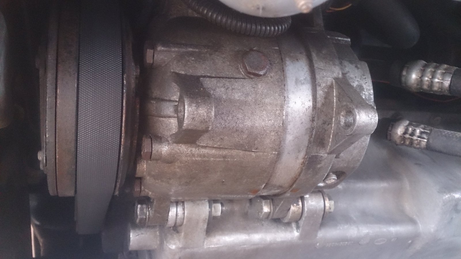

So, I found all the alternative makes/models. I can post the list here (can't assure that all of them are correct), if that doesn't go against any rules of the forum. It's actually easy once you identify the correct type. Here, it's a Harrison/GM V5. Alternatively, a Sanden type (I thin SD7V16, might have that number wrong though) can be used but it's more expensive and I think requires a slightly different belt. Right now I'm looking for the best deals for a V5 type, which for now seems to be the Nissens 89060. It has good reviews on the net and a good price, and is readily available from different places. Thanks for all the support.

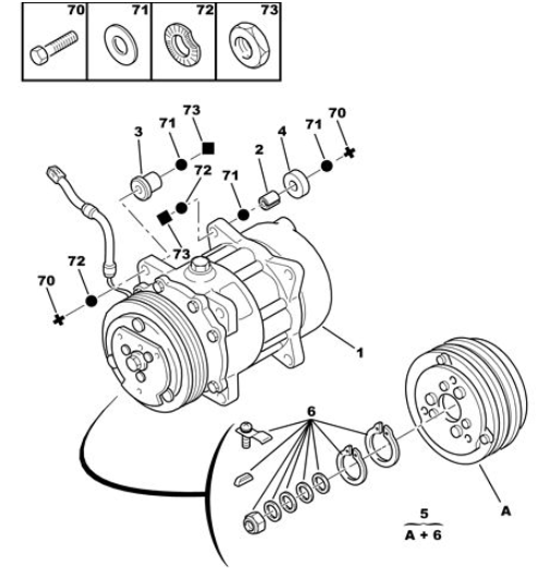

The official part number for a new compressor is: 6453 TJ. Costs new from Peugeot £964.46.
This part number could have several compressors under this part number:
SANDEN INT- - SD7V16 1106
SANDEN INT- - SD7V16 1227
SANDEN INT- - SD7V16 B068
SANDEN INT- - SD7V16 1218
The exchange part number is: 6453 TK and this was for a
SD7V16 QA1106 AND QA1227 and costs £512.30 from Peugeot.
Both the above are obviously UK sterling prices with 20% UK VAT included, so will be the equivalent in your local currency, but exclude a refundable deposit on return of your old compressor if going via the dealer. But at least you have the compatible parts id sourcing elsewhere.
So if you want an exact match try and match up the numbers on your old unit - however, if you had a Delphi branded original compressor, they are no longer available, so use one of the Sandens above.
