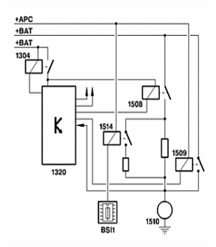

Paul - as per you other post, I'll put up some info on this specific system as fitted to the MK I with your engine. It may help you work out when the fan is operating and when not and which system controls what:
So this C5 has a single 500W Fan with 3 speeds. Below are the normal operating conditions:
Three Speed Fan Unit
Components
Key:
Ignition+: + ignition on
+ BAT: Battery +
Calculating the fan unit speed
The engine ECU sets the fan unit speed instruction depending on the following parameters:
The fan unit is fitted with 3 functioning speeds:
Post ventilation
When stopping the engine, the engine ECU controls the post cooling (slow speed), if the measured engine coolant temperature is over a programmed level.
The fan unit cannot be started in the following cases:
A fault concerning the fan unit (or the slow and fast speed controls) leads it to work in fast speed.
| Info | Data |
| 1st gear | 97 °C or air conditioning in operation |
| 2nd speed | 101 °c or 17 bar in the cooling circuit |
| 3rd speed | 105 °C or air conditioning in operation |
| Air conditioning cut-off | 115 °c or 30 bar in the cooling circuit |
| Warning | 118 °C |
| Post-cooling | 6 minutes |
| Temperature sensor | Temperature: Diesel injection , Warning , heating/ventilation |
Components
Key:
+ BAT: Battery +
| BSI | Built-in systems interface |
| 1320 | Engine ECU |
| 1304 | Injection double relay (engine relay unit) |
| 1508 | Slow speed control relay |
| 1509 | Fast speed control relay |
| 1510 | electric cooling fan unit |
| 1514 | Mid speed control relay |
- Engine coolant temperature measured by the sensor
- Cooling requirement linked to air conditioning, controlled by the B.R.A.C
- The engine ECU controls the slow speed and the fast speed
- The BSI controls the mid speed, depending on the information delivered by the engine ECU via the CAN network (engine coolant and air con circuit pressure temperature)
- Slow speed is obtained by supplying the cooling fan via a resistor arranged in series in the supply circuit.
- Mid speed is obtained by supplying the fan unit via two resistors wired in parallel on the supply circuit.
- Fast speed is obtained by supplying the cooling fan directly.
Post ventilation
- Operation in power latch (*)
- Switching off of the engine ECU electronics
- Engine starting phase

Lexia couldn't run the fan in slow speed in actuator tests.. I also could not make lexia clear faults.. It always tries to but can say faults remain. All I got was no communication possible..

- x 6945
Re: 2004 c5 hdi 110 cooling fan woes and now not running....
Was the engine running when you tried the tests? If not try that.citroenxm wrote: 20 Jul 2021, 20:40 Lexia couldn't run the fan in slow speed in actuator tests.. I also could not make lexia clear faults.. It always tries to but can say faults remain. All I got was no communication possible..
- Posts: 14310
- x 3296
Erm, the engine won't run!
citroenxm
- Fallen Hero
- Posts: 8061
- Joined: 30 Dec 2004, 23:10
- x 70
[quote="
Marc..
It ran the fast speed without the engine running.. Then slow speed it just clicked clicked..
As James says.. It won't run.. It starts after its first prime then stalls.. 20 seconds running only.
Marc..

- x 6945
I'm just coming in on the end of this at Paul's request - I wasn't aware it was a non-runner but now I know, that would make sense given the info I posted - the engine ECU controls the slow and fast speeds and the BSI the Mid speed - they all need to be running for the system to work as far as I can see... which may explain why you are getting the fan running with a direct feed, but not via the car as the other components are not running.
Yes of course Mrac. I appriciate your input. I think the engine ecu is dead. I've tried another bsm and I get same results..GiveMeABreak wrote: 20 Jul 2021, 20:57 I'm just coming in on the end of this at Paul's request - I wasn't aware it was a non-runner but now I know, that would make sense given the info I posted - the engine ECU controls the slow and fast speeds and the BSI the Mid speed - they all need to be running for the system to work as far as I can see... which may explain why you are getting the fan running with a direct feed, but not via the car as the other components are not running.
I'll get that 40 quid ecu and bsi with key off ebay and see what happens..
