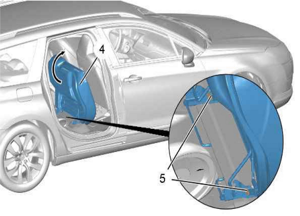

There are just some bolts securing it here:
Pivot the rear seat base (4) towards the front (following the arrow).
Remove:
The bolts (5)
The rear seat cushion (4)
Remove:
The bolts (5)
