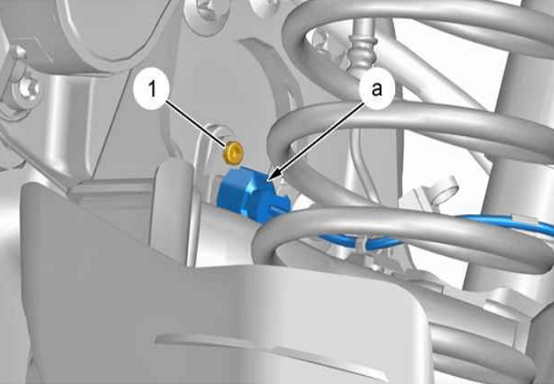

Here:

Re: Wheel Speed Sensor Fault
Post by mikeyerfdog »
Thanks, I checked that one. I want to check all the wiring right back to the controller. Where is that contrller so i can check that end's multiplug?
Post by GiveMeABreak »
It will go back with the others to the ESP / ABS ECU which is at the rear of the engine bay near the left front wing (standing in front of the bonnet).
Thanks,
I think you might me right tho. I have the 2pin plug a wiggle and it cleard last night. Will get the wheel off this weekend and confirm for sure.
Thanks for your input tho...
