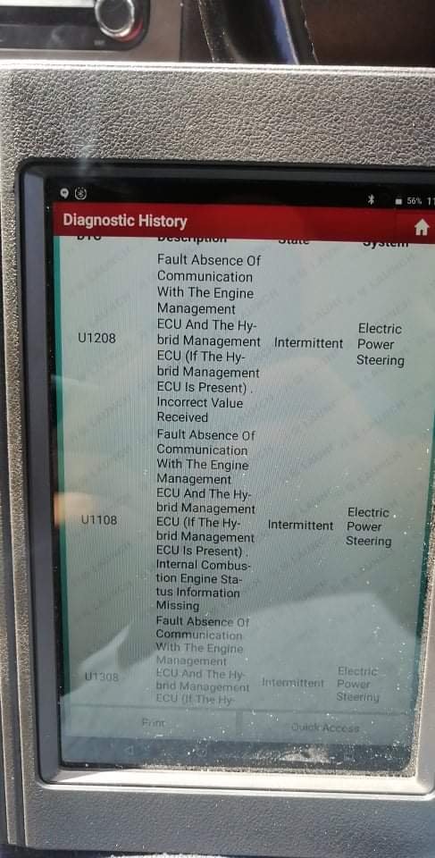

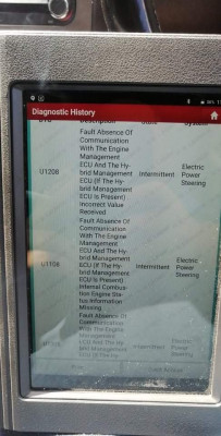

On diagnose it gives now errors from the electric power steering - absence of communication with ECU, (U1108, U1208, U1308) - intermittent. From the driving point, I can't feel any difference and if I accelerate it from pedal and then set the cruise control it's working fine.

U1108: No communication with the engine management ECU fault: No signal
U1208: No communication with the engine management ECU fault: Data invalid:>
Possibility 1
-The time for recording the fault code is 500 milliseconds
- The clutch pedal sensor values sent by the engine management ECU are not coherent with those of the ESP ECU
Possibility 2
- The time for recording the fault code is 500 milliseconds
- The datastreams from the engine management ECU are not valid
Possibility 3
- The accelerator pedal sensor values sent by the engine management ECU are not valid
U1308: No communication with the engine management ECU fault: No signal:>
Possibility 1
- Data from the engine management ECU absent
Possibility 2
- Incoherent data coming from the engine management ECU
These can all be to do with a failed download of the engine ECU, fault on the CAN network , Electrical Connections, ESP ECU - Have you undertaken any work on the wheel speed sensors / brake discs / pads lately?

No underworks on the wheels /pads / sensors. Those 3 error codes where shown only once and after deleted never appeared back but now the are no codes but still the cruise control goes off when it needs to reach the speed and is working fine after I stop the engine and leave it for a couple of minutes. I can't feel any difference when I accelerate it, with the cruise control working or not. Also, if I press the pedal all the way down the car goes very well with no issues. As there are no fault codes now, I don't know what else to do... It's really annoying!
