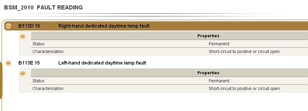

I read the fault codes and got some errors which indicates to a "short-circuit to positive or circuit open" in both of the daytime LED's. The codes are: B113D 15 and B113E 15. See the attachment.

Hi, from the looks of things, the faults for the DRLs can be any of the following:
The LED Unit itself
Electrical harness
Switch module at the steering wheel
BSI
Engine Fuse Box

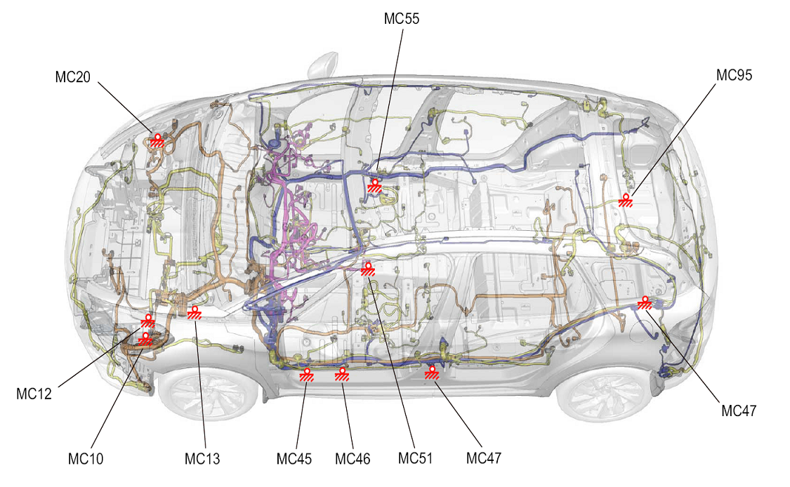

This may not be much help but here's the diagram for you:
The 2 main DRL control wires are (2400A and 2405A) and as you can see these are routed directly to the engine fuse box. The are no fuses I can see for these.
2610 is the left headlamp
2615 is the right headlamp
ME10A and MC10A are the earths, which are shown below at the MC10 location - so you may want to check connections there in the plugs for water ingress.
Click Image to Zoom
Click Image to Zoom
