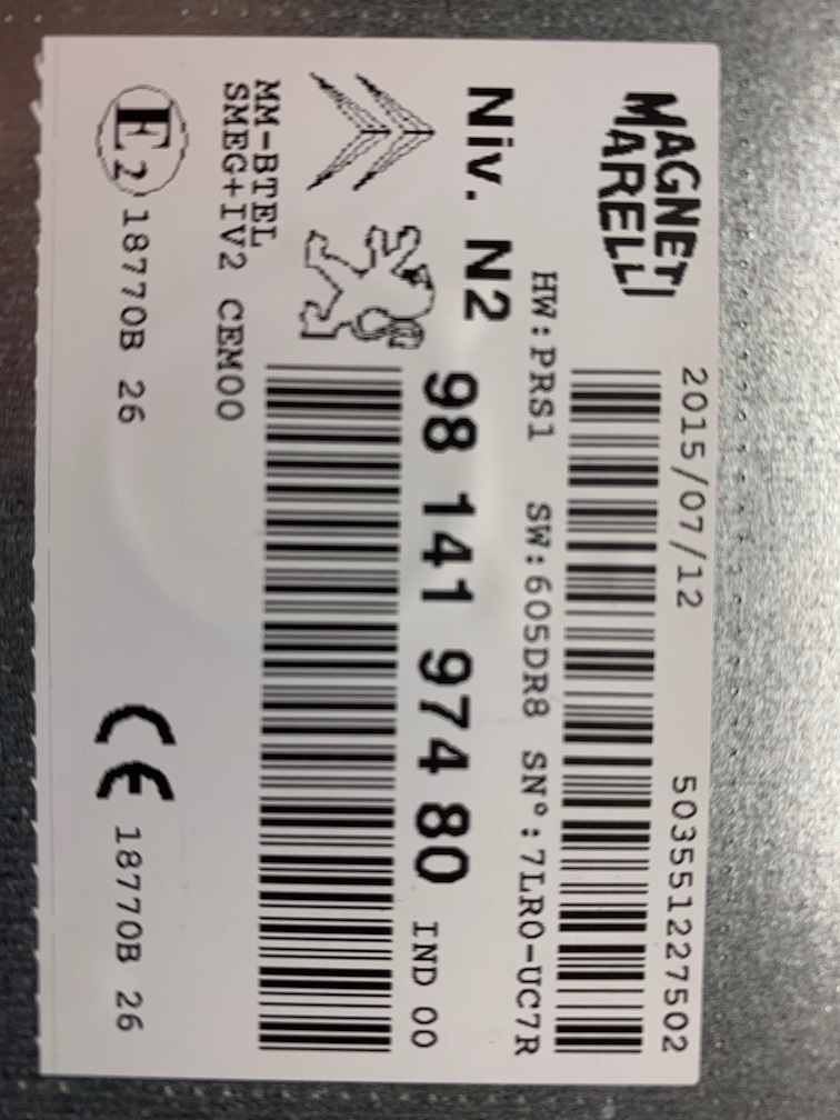

If you have your old unit, take a picture of the labels and try and get the long number to find a used on - here's a SMEG+ IV2 from a DS3:
https://www.ebay.co.uk/itm/274860764640 ... Sw3zFg5sv2
See if the part numbers match up from the back of the units

Just use the numbers from the label on your unit to search for a secondhand unit on eBay or other places like that the long number will begin 96 or 98

Might be a long shot to find the exact same serial number as his...
My SMEG+IV2 from 2015 DS5 is 9814197480. But as long as it's a SMEG+IV2 from any PSA car it will do. Just needs automatic VIN telecoding at delership and it will be calibrated to your vehicle - same as you (now dead) original head unit.
