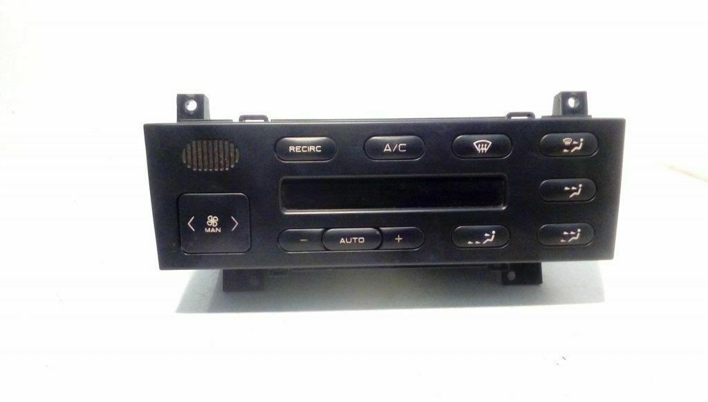

My 406 has this head unit:

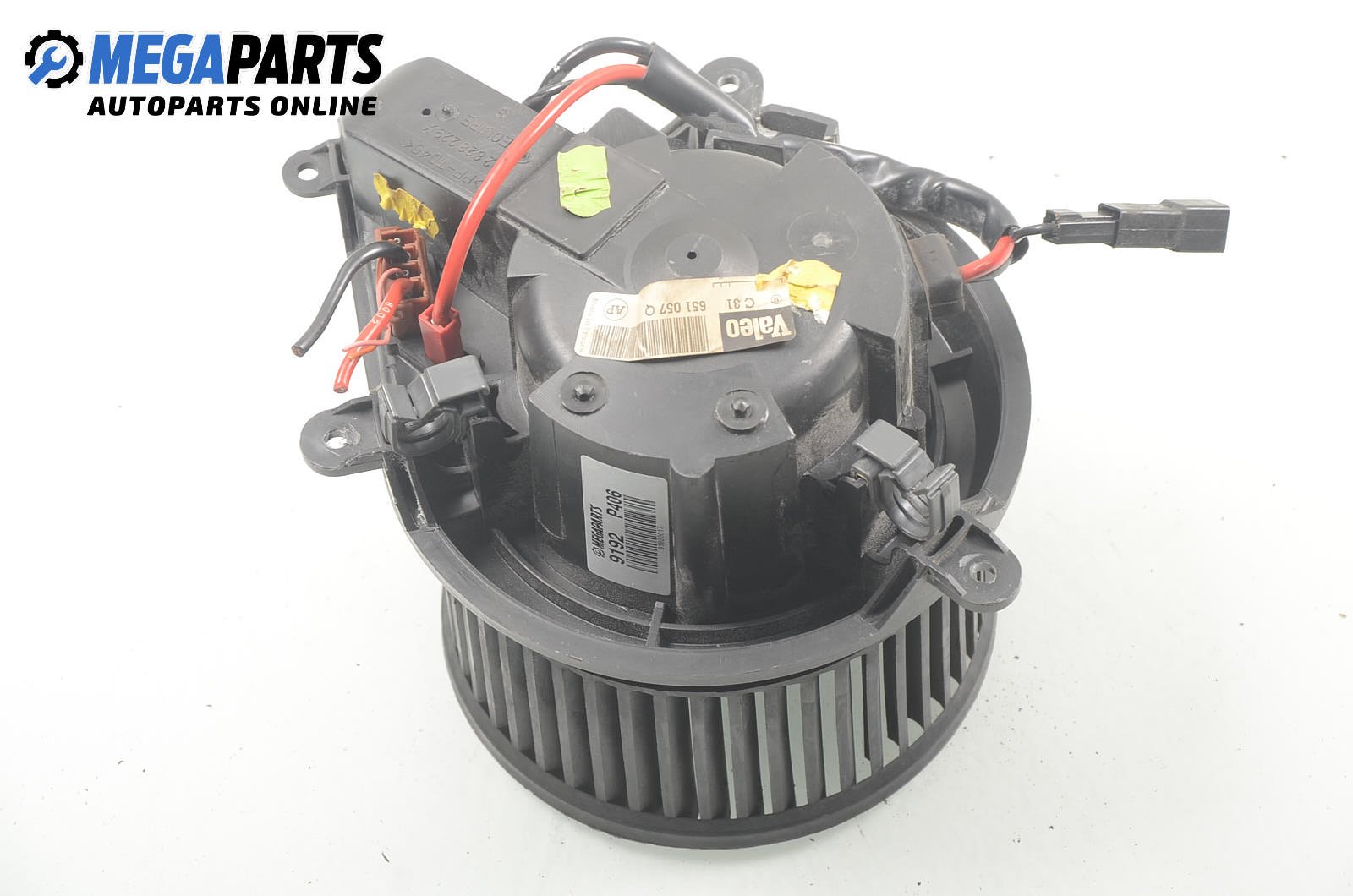

But here's a photo of the motor I SHOULD have:
On this pic it's not clear, but the black connector with the small gauged wire is connected to the thick black ground wire for the motor winding, so it basically carries the pulsed ground back to head unit for feedback... That's probably for safety - If that feedback is not present, the motor (or the power transistors on speed control module) has failed and the head unit won't send the PWM signal over the rosa control wire. I was unable, btw, to find out what the orange control wire is for. But connections are exactly as on this image. Mine had all of them, EXCEPT for the black wire with black connector (which has it's counterpart in my car, but with a thin BROWN wire).

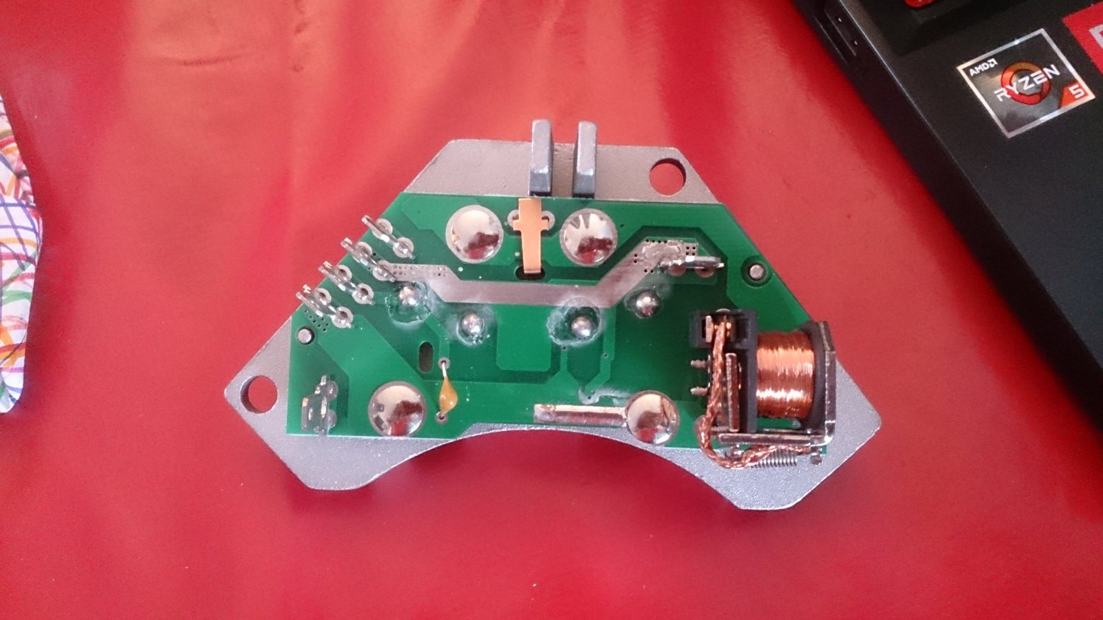

So, after taking it all out, first thing was to give the motor a good clean (and deoxit spray application and lubrification). Then I took out the speed control module, which was looking really bad. Gave it a clean and noticed a "apparently" bad spot around the area where there seems to be a little "spring" that makes contact against a little disc on the heat sink. It wasn't making good contact. Thinking it was bad (although the transistors were measuring fine) and not being able to find any badly connected wires (hadn't seen the black connector yet), I went to part store, returned the wrong module and got a module that at first sight looked fine, this one:

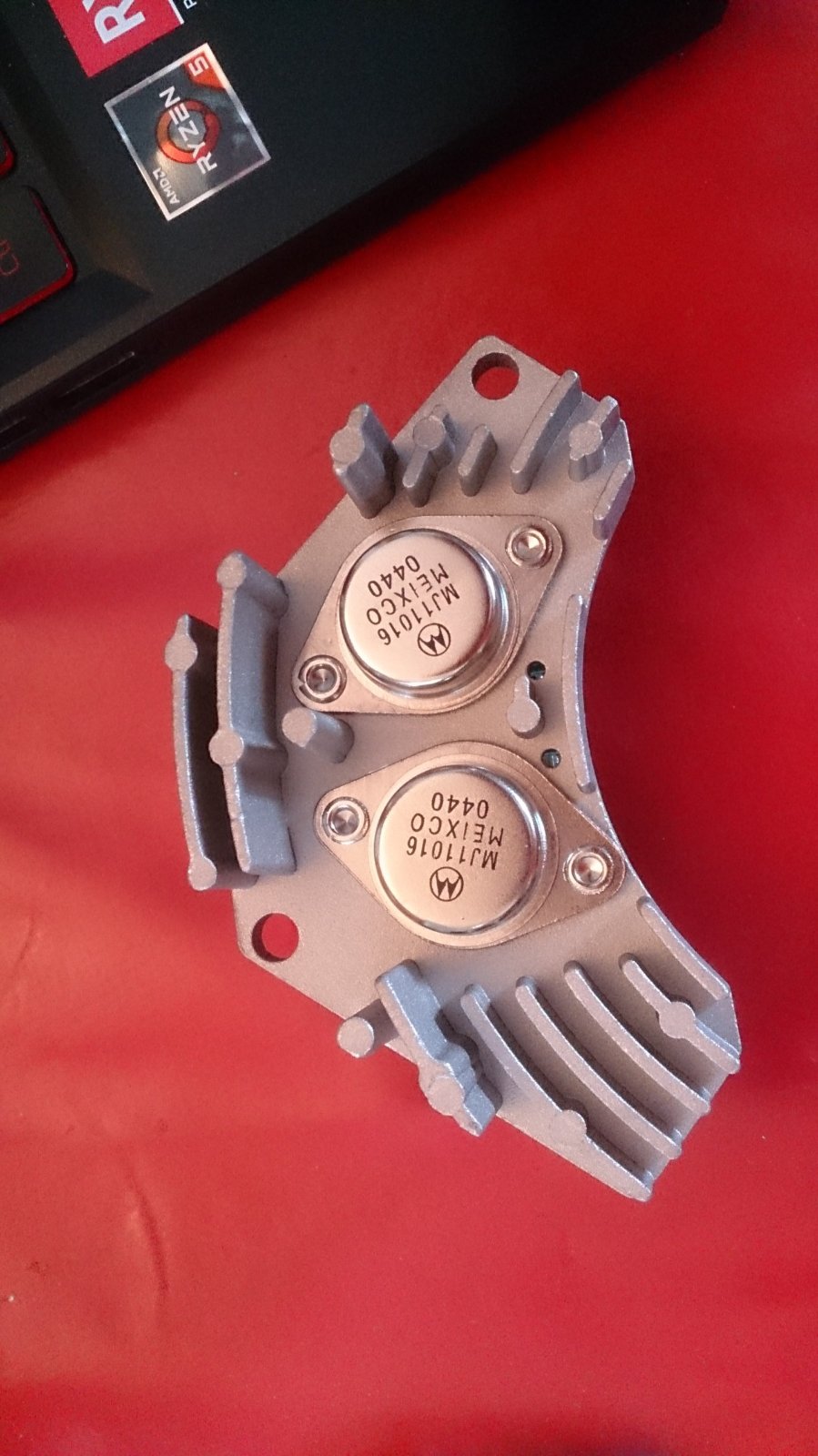

If you have a 406 and find this on the net, do NOT buy this module. It works "backwards" (has NPN instead of PNP transistors, which means it's inverted, it pulses +12V instead of GND, which does NOT work for these cars. Maybe for some Citroen. Not sure. Unfortunately, there are some other similar versions from other companies, which don't work, and then there are a few, including the Valeo part (which is what I have, photo below), which DO work. Here's a topic that covers this (only found the topic much too late): viewtopic.php?t=64495
Stupidly enough all them go under same OEM part number, 6441.78.
As you can see, the little spring on mine is gone... that was the unfortunate result of trying to "fix" it (yes, sometimes I also break things :D), as it was making bad contact to heat sink (turns out it goes against a small disc shaped thermistor). I think that might be what the orange wire senses. If thermistor burns out (or resistance gets high) due to overheating, the continuity to heat sink is lost. So I had officially "deactivated" my control module, without wanting to. That was too bad, as I had just found out that the new module I had bought was the wrong one, too, and that this old module seemed to work. I installed a resistor instead. Might not be the safest solution, as it might allow the transistors to die, but I'm going to be careful with blower motor, avoiding to run it at high speeds. And I never tested module outside of fan! it needs the fan running to cool down...

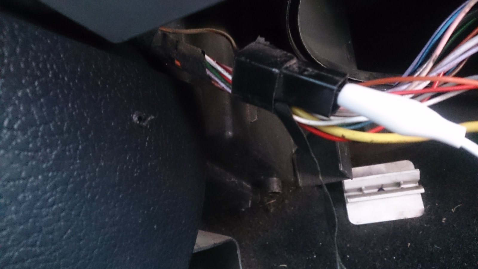

Here's photos of the infamous black connector:
With cable soldered to it:
Sorry for the low quality and quantity of pics, but this was a really tiresome adventure, and when I had it done, it was late already, I forgot to take more and better pics.
