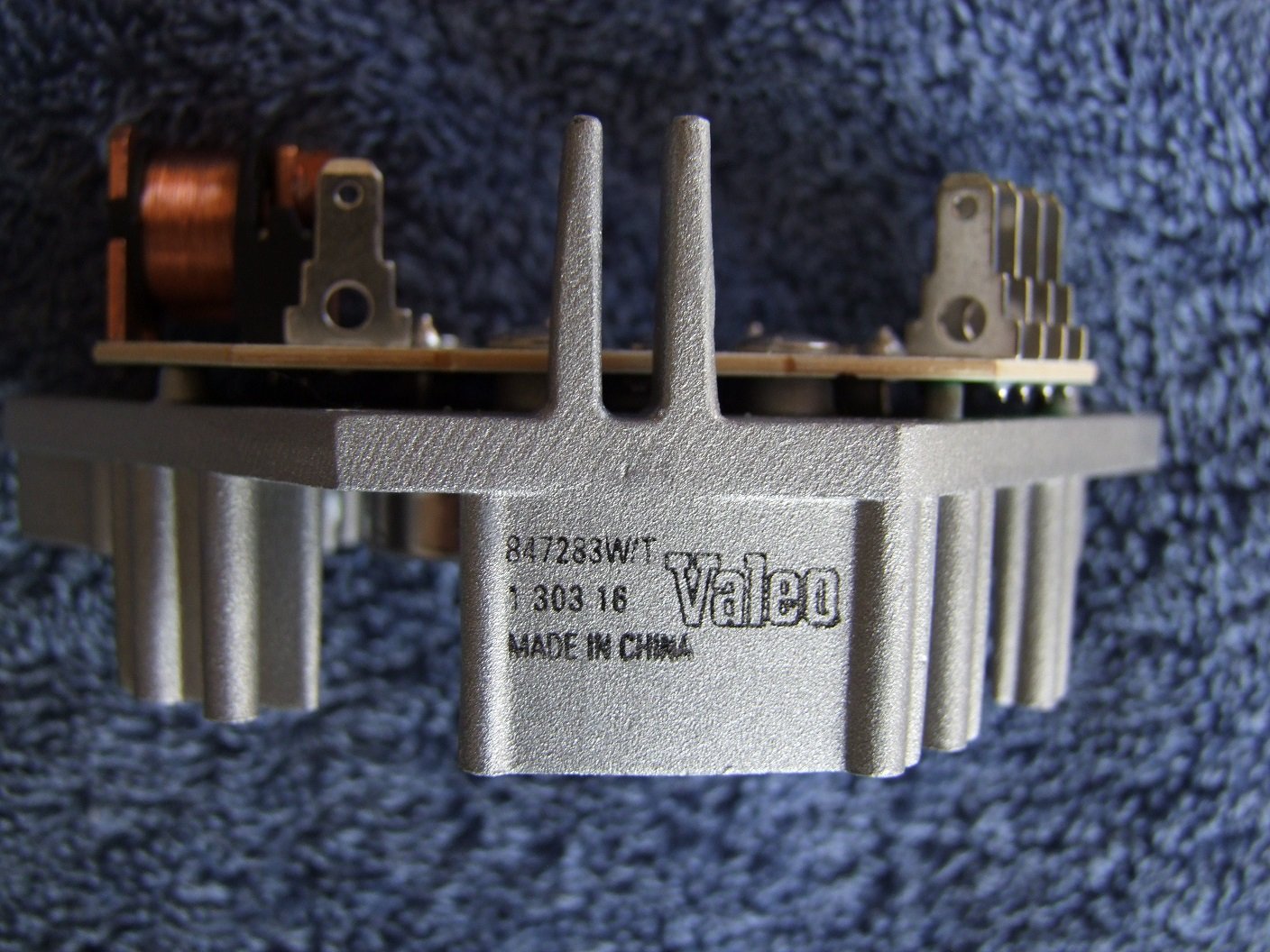

The module has a Citroen/Peugeot part number of 6441.78, and is still available (at £165.66 incl VAT), having been fitted to a large number of cars - including AX, Berlingo, Saxo, Xantia, XM, Xsara, ZX, and equivalent Peugeot stablemates.

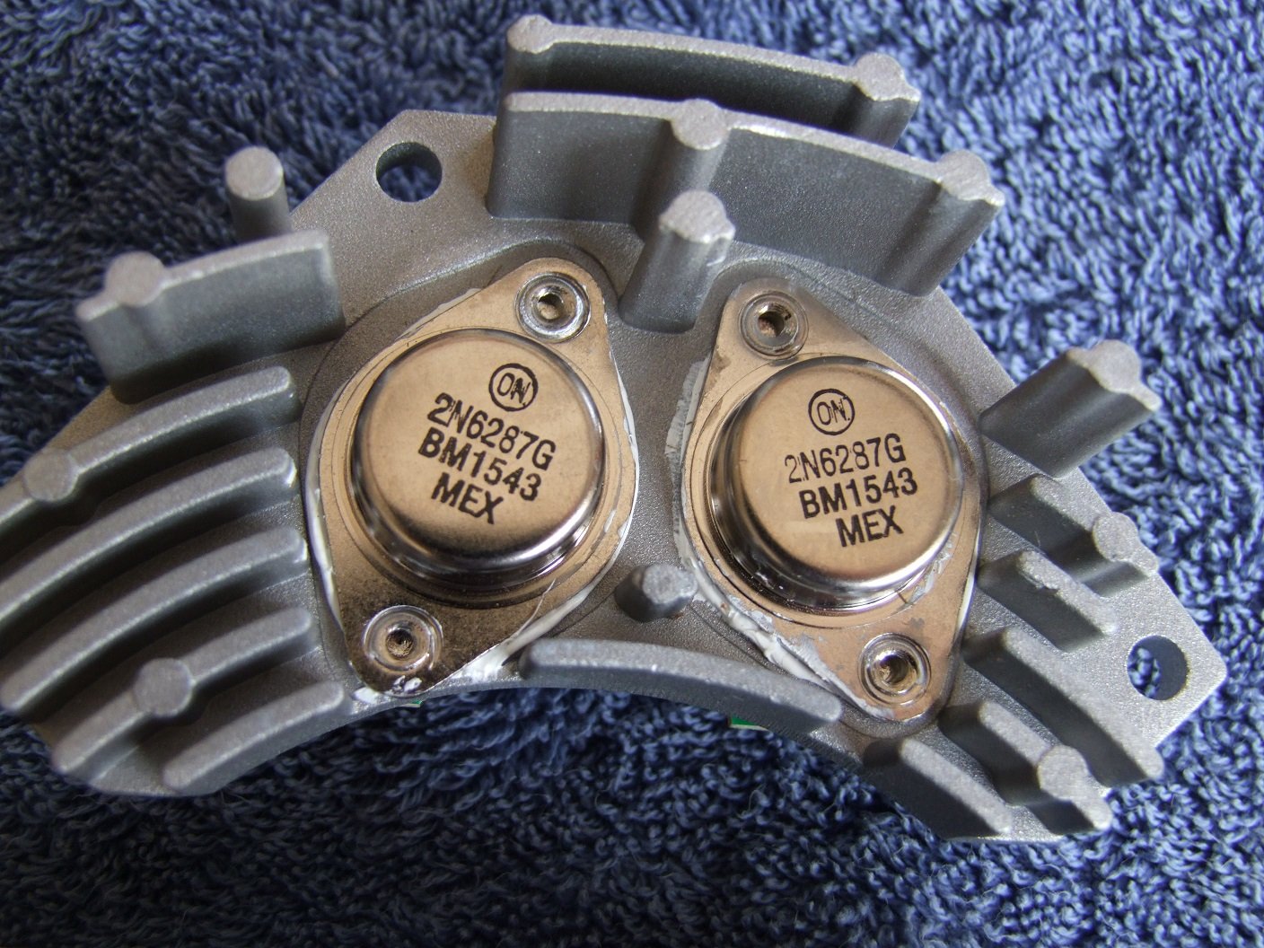

The module has remained unchanged over many years, but the two large power transistors have varied over time. In recent years, those that work have included ones marked 2N6287G, ST26025A and MJ11015.
Any fitted with MJ11016 are the wrong type of Darlington transistor, and unsuitable for use. Some Chinese copies had these fitted, with an altered circuit board.

Having just laid one in as a spare, I got its authenticity checked with Valeo UK, and it is exactly what they have on their own shelves.
It ran up on the bench under full load without any problems.
Hopefully, this will help identifying pukka modules, which are available from a good many sources.
