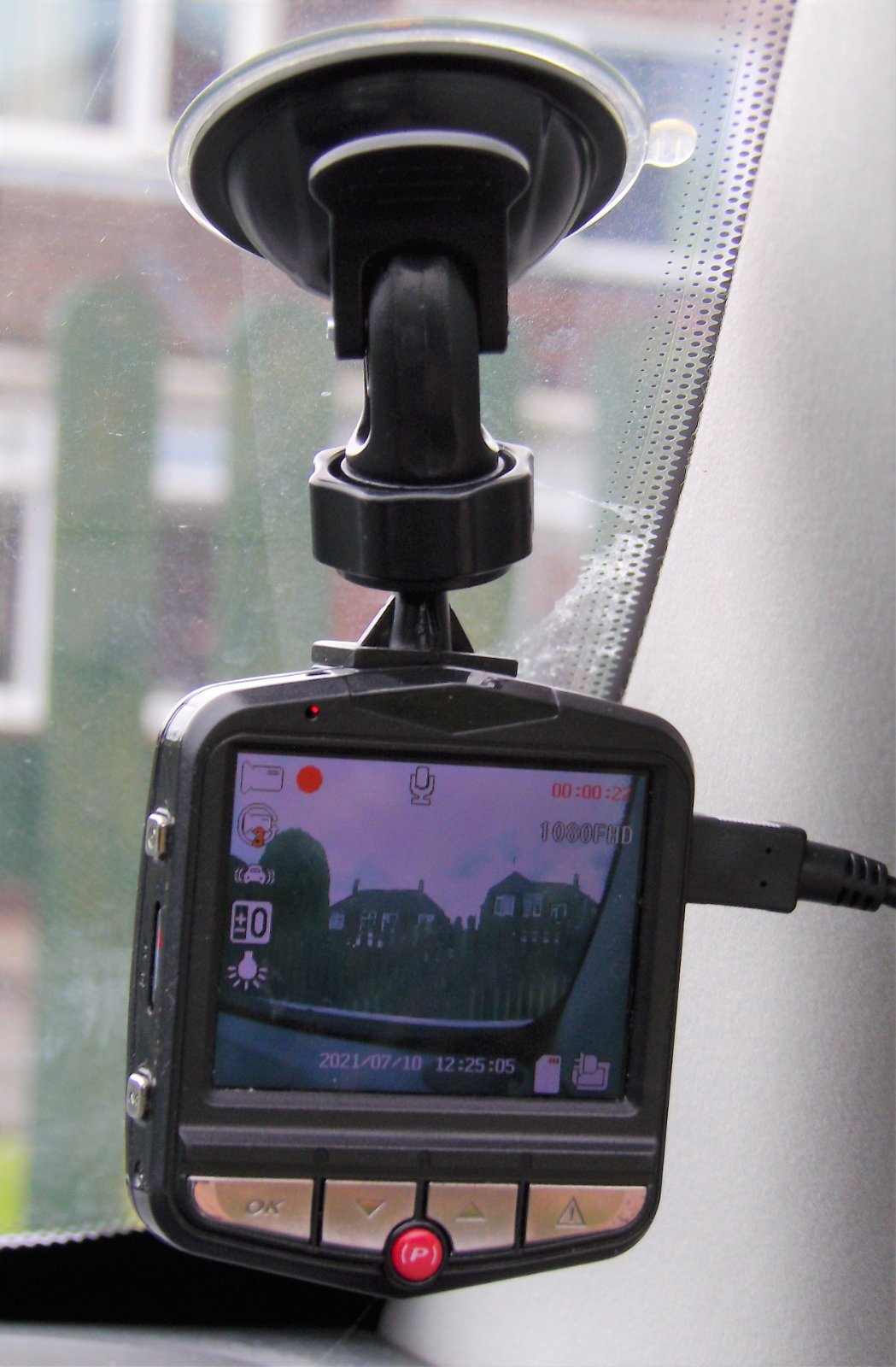

I've got two cheapo dash cams that work fine but I tried to upload a short bit to this forum a few days ago without any joy, need a lesson.

Trial run. Note the speeding DPD van.GiveMeABreak wrote: 09 Jul 2021, 20:40 You'll need to upload your clips to YouTube first, then when it has been processed, YouTube will give you a link Eric, then just post the link in. Just make sure you make the Video publicly available when confirming the age restrictions etc.

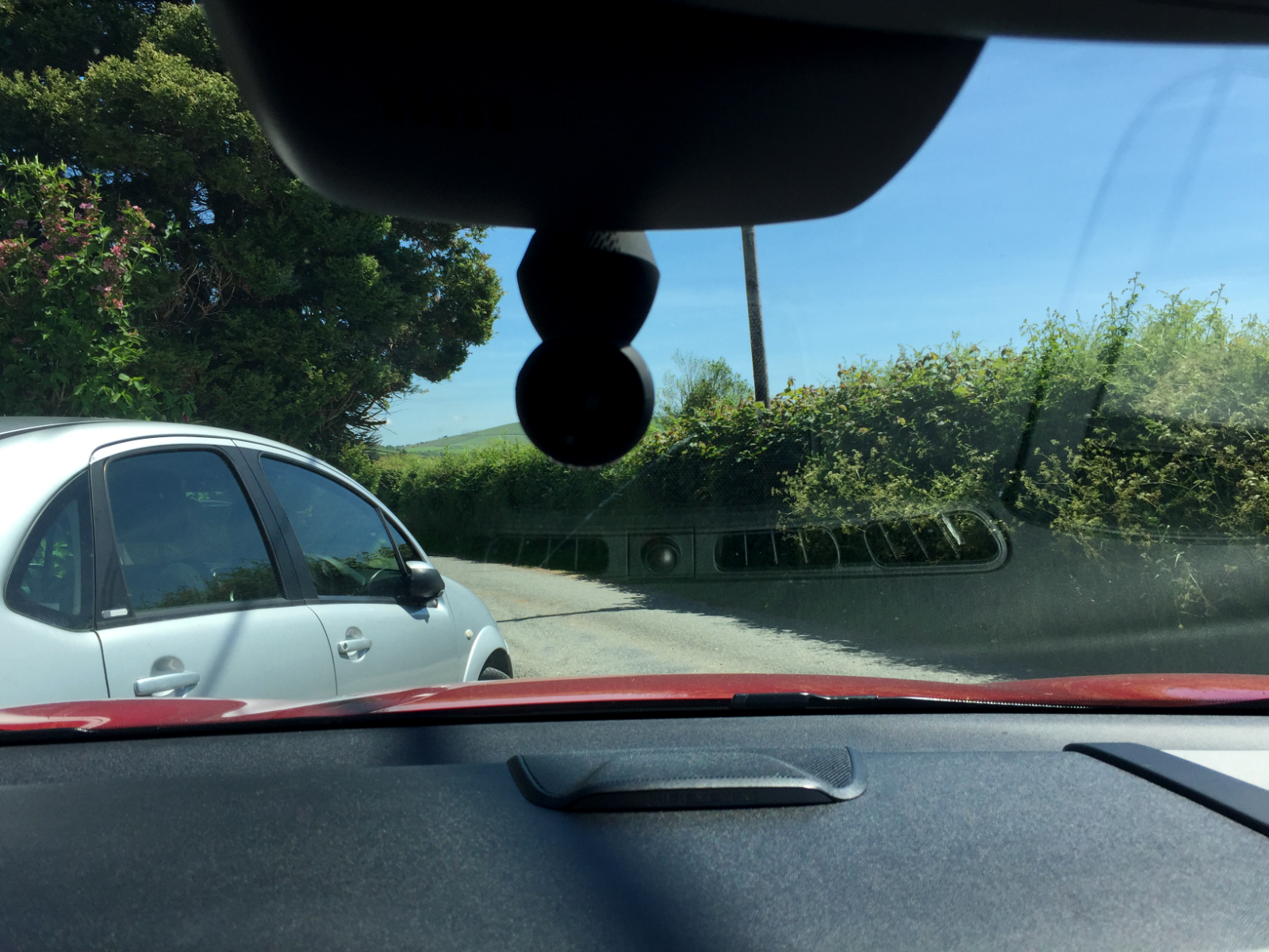

Not bad, but might I suggest you mount the dash cam up behind the rear view mirror. That way the camera captures more of what happens on the road (and not the vehicle it is in). Most dash cams come with a long enough power cable to go around under the windscreen trim (and not across it). Mounting the camera behind the rear view mirror means that (if you cannot turn the screen off) it is not a distraction (so would not cause any Police to take a second look), and is not in the "must not obscure driver view" region of the windscreen.
- x 2941
Re: Dashcams
I've tried it in a few places, not really bothered too much, up behind the mirror has the rain sensor dotted area which is a bit of an obstruction.
As you say there's plenty of cable to reposition it.

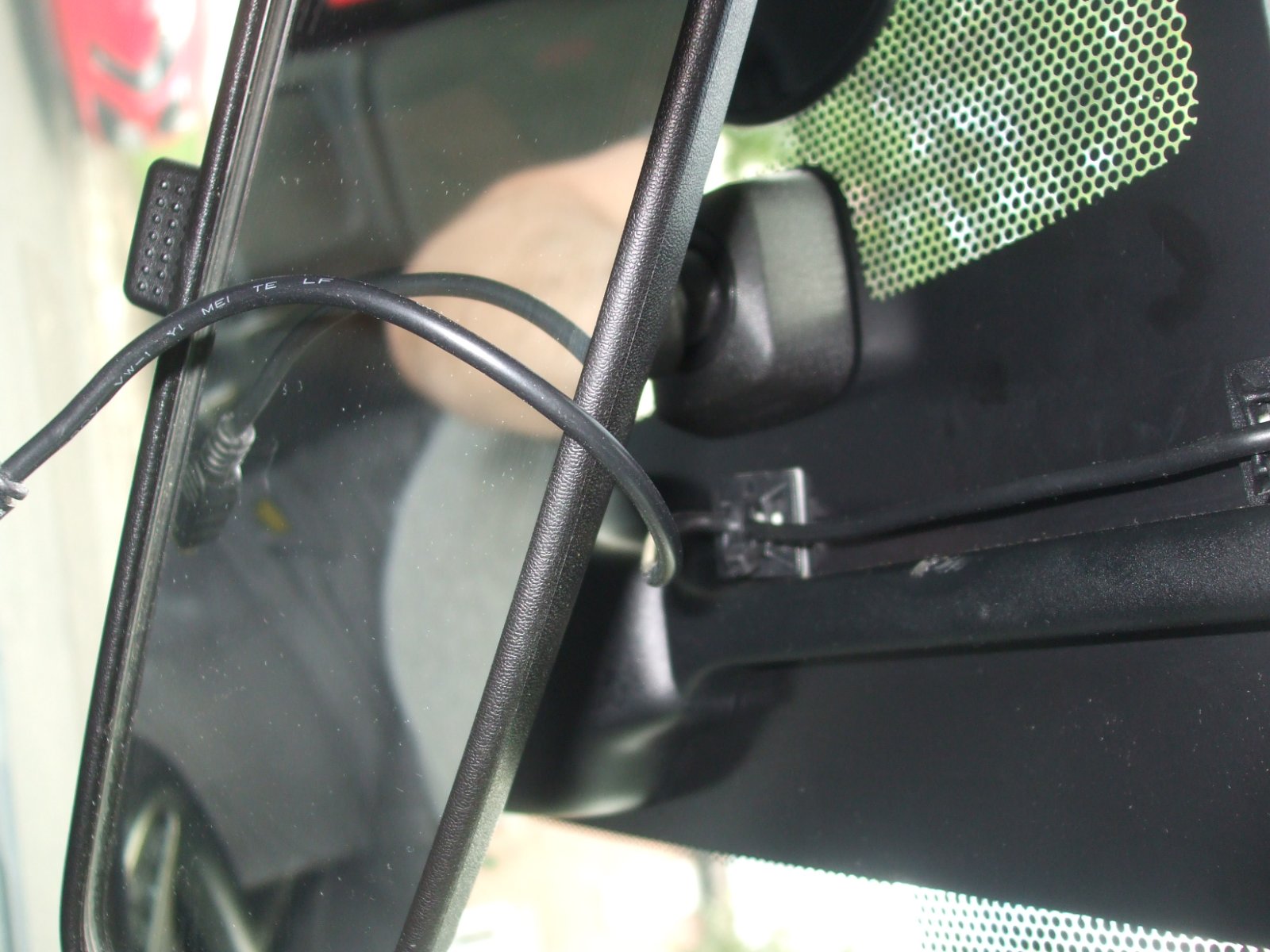

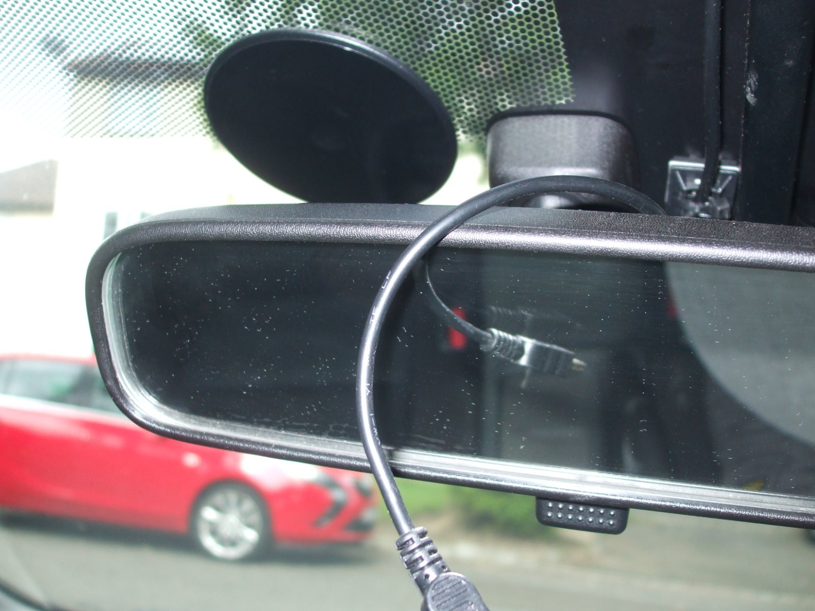

Due to the wide and long sensor / camera shroud area on the windscreen, I had to reposition mine underneath the console on the windscreen to get a 180° view as you can see...
See my illustrated guide I just did with the same issue:
viewtopic.php?t=68734&hilit=navitel

Re: Dashcams
Forget the rest of the install Eric - but as you can see
| Original Mounting | Original View Can't see anything coming from the right. |
| New Centre Mounting Positioned Under the Shroud | Improved 180° View Now the camera can see left and right without obstruction. |
