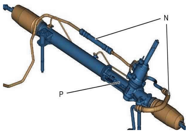

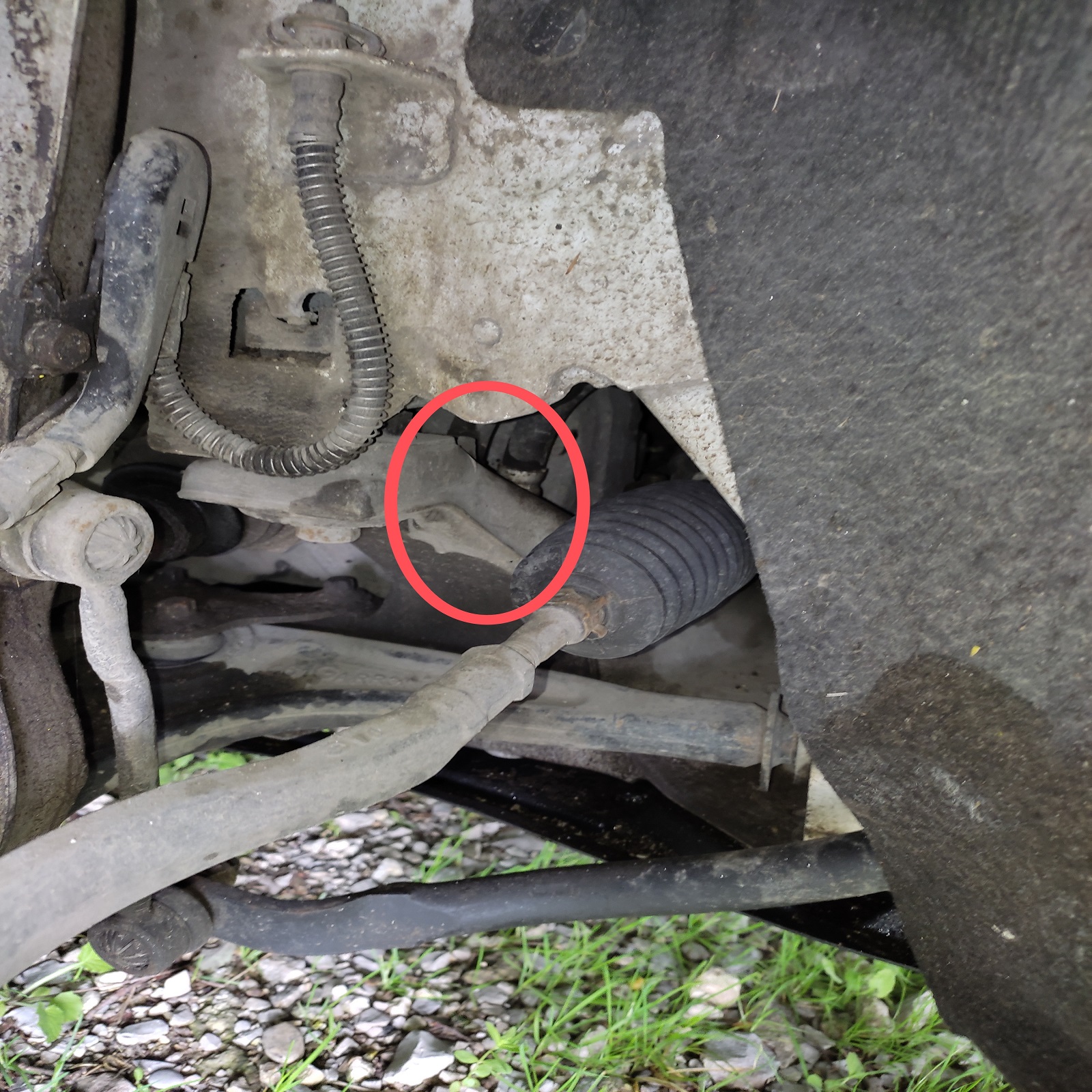

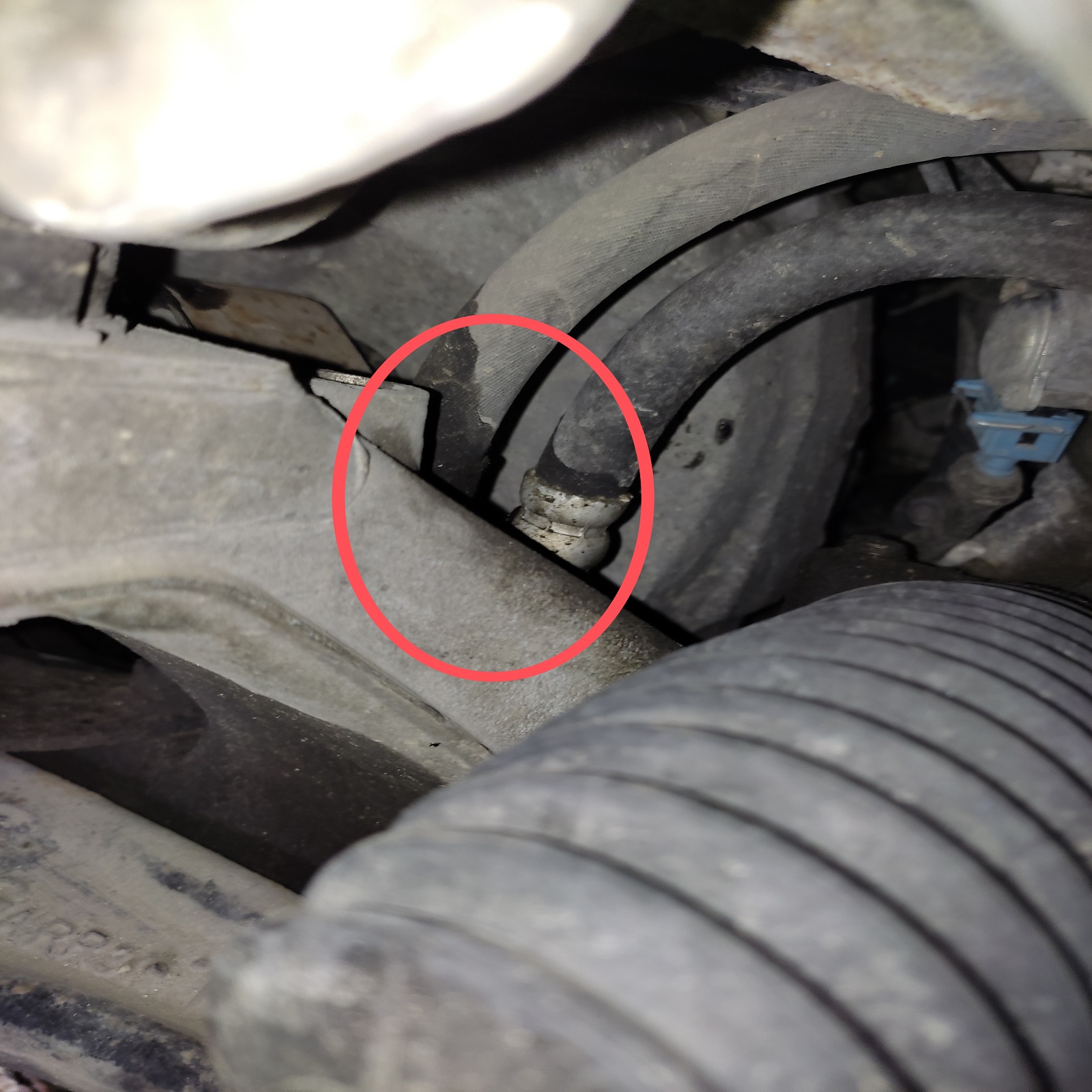

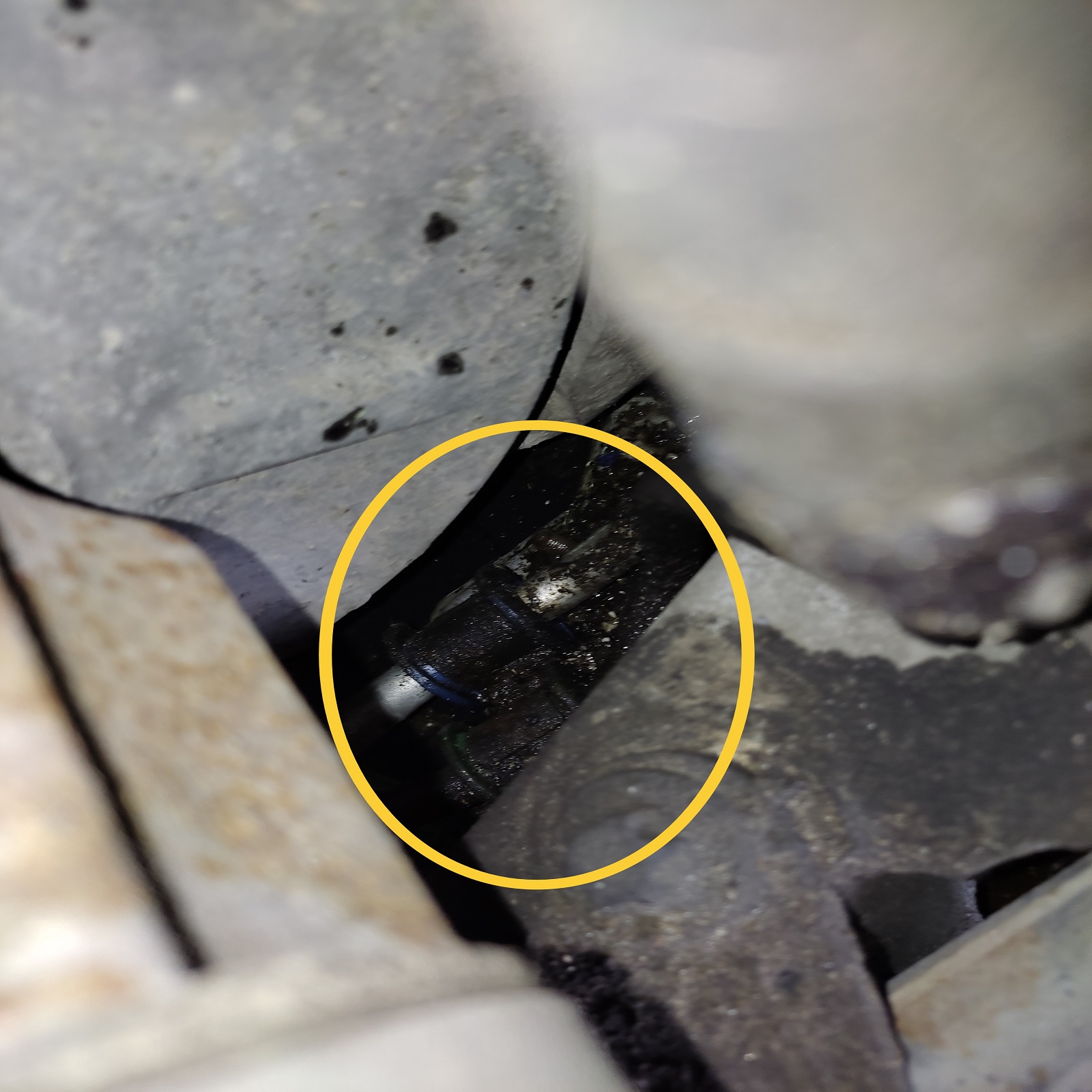

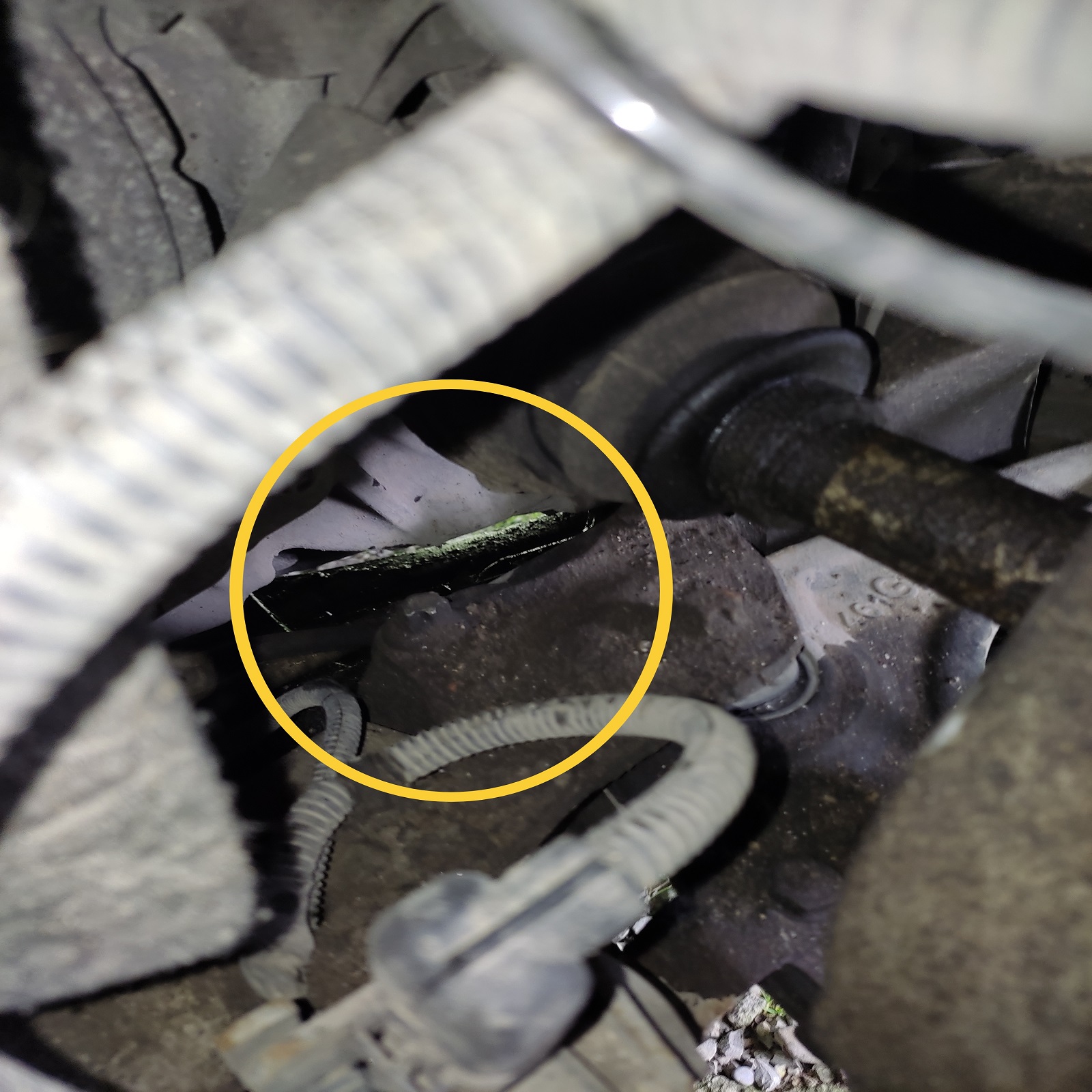

Ok, so this looks like it is the low pressure piping - but to be sure here are both the low and high pressure pipes in this area for you to confirm - with recommendations for both, but I suspect it is the Low Pressure Piping ("N2"):
Main Area of Leak - Steering Mechanism Zone
From your pictures, I would suggest Zone "N":
"N1" High Pressure Piping" |
Information
"N2" Low Pressure Piping" |
Information
