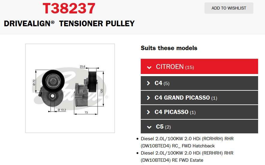

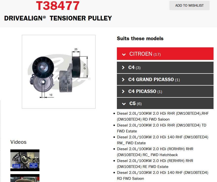

Coincidentally, I've just been researching the correct aux belt tensioner for my C5. There appear to be 2 extremely similar tensioners available for the DW10BTED4 engine, but their dimensions differ very slightly. Dayco list two tensioners - APV1114 and APV1028 and both will fit the C5, it's the same with Gates - T38237 & T38477, but they're not quite the same size. Confusingly, Febi and others list their tensioner as being compatible with both sizes.

As far as I can see, the 67.7 & 55.5 refer to the depth of the whole unit i.e. from rear mounting face to the tip of the roller fixing bolt. The Gates equivalent has the roller width as 25.0 on one and 25.6 on the other. Unhelpfully, one of the Gates ones has the overall width as 73mm, which doesn't tie in with anything

More confusion......
The applications list for the Gates belt shows a crossover with some of the C5 variants.
