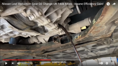

I would think this screenshot from a fluid change video would look hopeful from a "remove the box only" point of view unless some of the retaining bolts are at the top and inaccessible without removing the gubbins above.mickthemaverick wrote: 26 Jun 2021, 23:01 Obviously the job will have to be done from underneath but having removed the outer cover you should be able to diagnose the actual problem and then go from there. Unless of course there just isn't room due to the chassis or something preventing access from that direction.
Screenshot Regards Neil

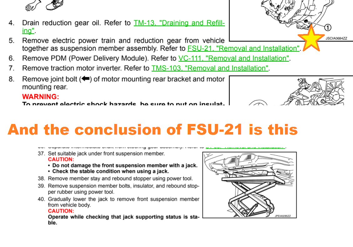

Of course the NISSAN official guidance envisages an altogether more awful set of procedures to remove the "gearbox".
Very Haynes-esque reading and very very off-putting requiring lets say dismantling of everything. So to remove the gearbox their method is to in old fashioned language, drop the subframe with everything attached (car up on a lift subframe dropped onto heavy duty jacking platform and lowered to ground level).
Is it too early to say surely that has to be a load of unnecessary work, and well worthy of an MBE if the home mechanic could ever follow all of those steps.
The Mick method surely has to work, and if it doesnt I would abandon all ideas of taking the engine out yourself.
Electron garage may well be your best choice.
I may have got it all wrong but this is what I gleaned from the "official instructions"
