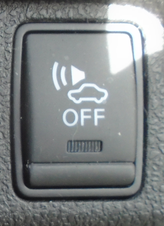

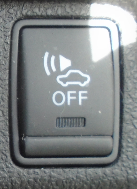

Simon,
A couple of questions if you dont mind.
Does this button on your car have any discernable effect? ie does your car make the low speed noise either forward or reverse. Mine doesnt even though pressing the button does activate the little light on the switch.
Also, you may know I abandoned all efforts to do the Nissan Connect thing. Never missed it can happily do without it. I'm sure you will have it singing and dancing, but is there a subscription you have to take out for the connectivity?

I wonder if that switches on an external speaker to allow people to hear when the car is approaching (maybe by playing the sound of an engine through that speaker)? I know that some electric cars are almost completely silent at low speeds.

Yes the button works on my car. The button is actually a pedestrian warning sound disable button. So when the light is lit the sound is disabled. When you start the car it (by law) always defaults to the sound being enabled, which is the light being off.NewcastleFalcon wrote: 21 Jul 2020, 18:39 Simon,

If you're driving around in urban areas where pedestrians are likely to walk in front of you it's probably best to leave it on, however if you're trying to come and go from the house at early hours and don't want to bother the neighbours you can turn the sound off, which makes it almost silent when moving slowly.
The noise comes from the front of the car somewhere and sounds like a tone which varies in pitch with road speed and isn't particularly audible from inside the car I find, however you'll hear it if you wind the windows down and drive along beside a wall.
The tone stops when you're stationary and also stops when you go above 20mph. To confuse matters the motor itself (or maybe the drive inverter) under the bonnet also makes a tone like noise at lower speeds so when the pedestrian warning sound is active there are actually two different speed sensitive tones that are audible...
The warning sound only operates in drive not in reverse. I guess for it to be useful in reverse there would need to be a separate speaker at the rear and they decided not to do that for whatever reason. Personally I think a reversing warning would be more useful than a forwards moving warning!

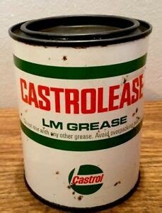

There you go Neil!

Thanks Mick! How much is a tin of grease these days? I have lost touch. Last one I had was black stuff molybendum (close molybdenum grease) or something like that! lasted years and there is probably still a scraping left.

Anything from £3.50 to £450.00 depending entirely on what you need it for!!

I'll have a tin of your finest £3.50 please!
