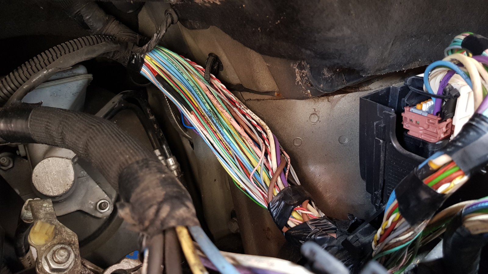

I have checked the suspect area of the wiring loom for corrosion/breakages but it all looks in excellent condition (attached)
I have performed another BSI reset using your Door Latch workaround but no effect on my faults unfortunately.
Car dash goes off about 10 seconds after turning ignition on stating 'Energy Saving mode Active'

Have a look at this video - these have notoriously bad wiring issues. It may help you:

Very interesting, I think I saw that a few weeks ago which led me to investigate the wiring in that area but couldn't remember where I had seen it so Thanks!!
I will try some further investigation when the rain goes off.
Gary

No worries - there should be a link in this video to his original video too. I've seen wiring breaks in this loom many times - sometimes hidden deep inside the bundle - they are just too heavy for the poor quality wiring and combined with the stress and vibration from driving, this causes additional tension on individual wires and the inevitable breaks to occur.

"sometimes hidden deep inside the bundle..."
Oh sh!#... that doesn't sound good but fingers crossed
- x 6947
Re: Help! ESP / HandBrake / Parking Brake Fault U1313 (Will not Start) with Lexia/Diagbox fault report
Hopefully not, but 'gently does it' when handling these when investigating comes to mind. But as he says, check the wiring back from that fuse to eliminate that as a cause.
