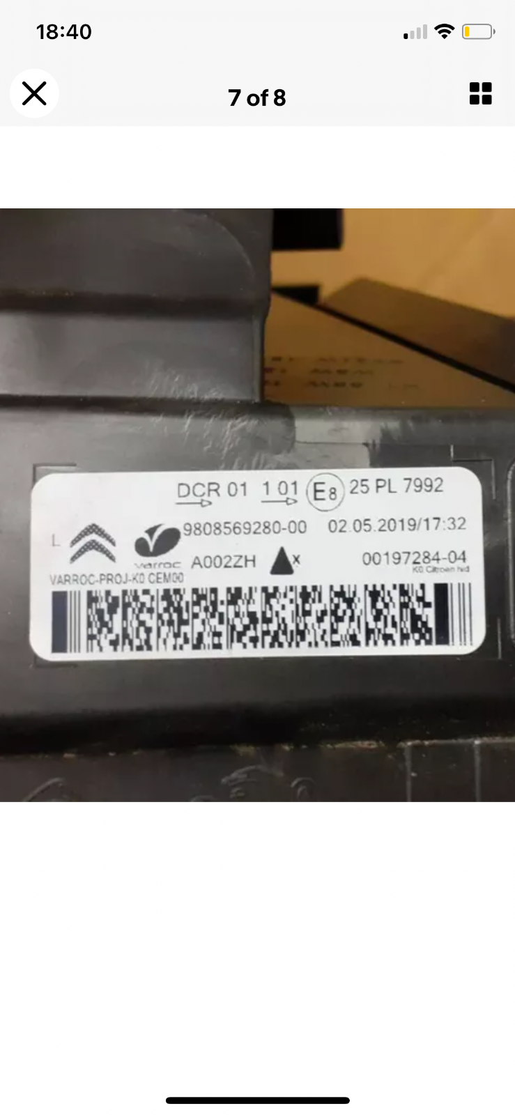

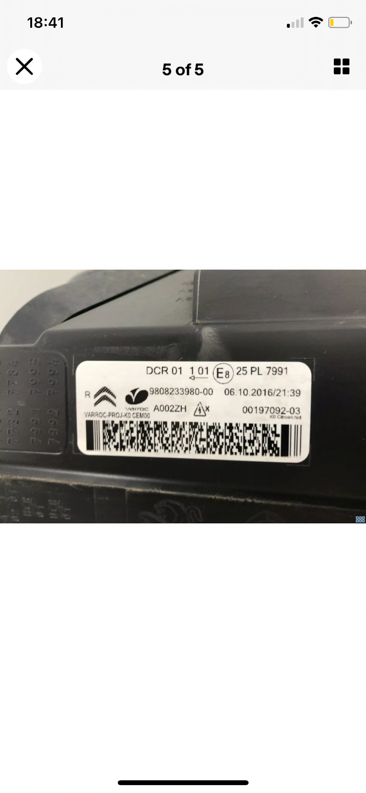

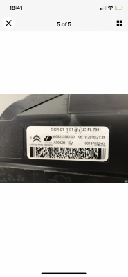

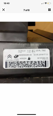

The lights were genuine headlights for this vehicle
- x 6947
Re: Xenon headlights
Yes, I understand that, but there are 2 versions of Halogen and 2 versions of Discharge headlamps available for this vehicle - each depending on the build date of the vehicle.

Ok, so that would be helpful when you have it, along with the Citroen part number of the headlamps you bought.
Mark H
- Posts: 8
- Joined: 23 Jun 2021, 13:18
- x 1
They both came from eBay one from the uk and the other from Germany but once the vans back I’ll be able to check
