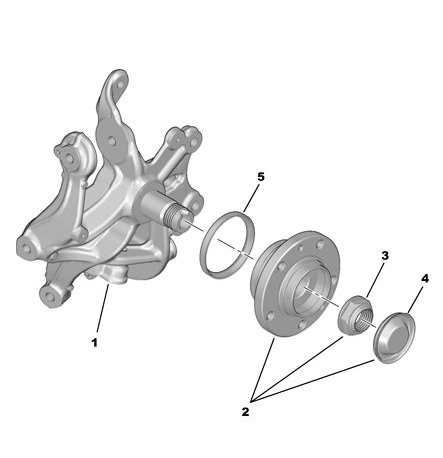

Can't help you with that link Pete as I'll only supply proper PSA part numbers - which in this case are:
The Kit is part (2), which includes 2, 3 & 4.
OEM original Part is: 374887, priced £111.44
Cheaper Peugeot Alternative is 1623942480, priced £53.09

Thanks , that's the same part number.
