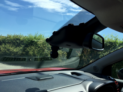

I had to risk it and mount it in the centre. The only place for this was underneath the central shroud.
Tip: If you need to remove the 3M mounting Pad from the windscreen, don't try and pick it off. Get hold of a hair dryer and gently heat the outside of the windscreen directly behind the mounting pad. Use full heat for about 1-2 minutes to loosen the adhesive. Then with one hand on the inside of the vehicle, hold the mount and apply pressure in one direction only whilst continuing to apply heat and it should at some point just pop off in one go. If successful, you should be able to reuse the mounting pad and keep any spares you have for future use.
As it turned out, this did not distract the driver's view at all thankfully.
Note: this picture was taken from the passenger side.

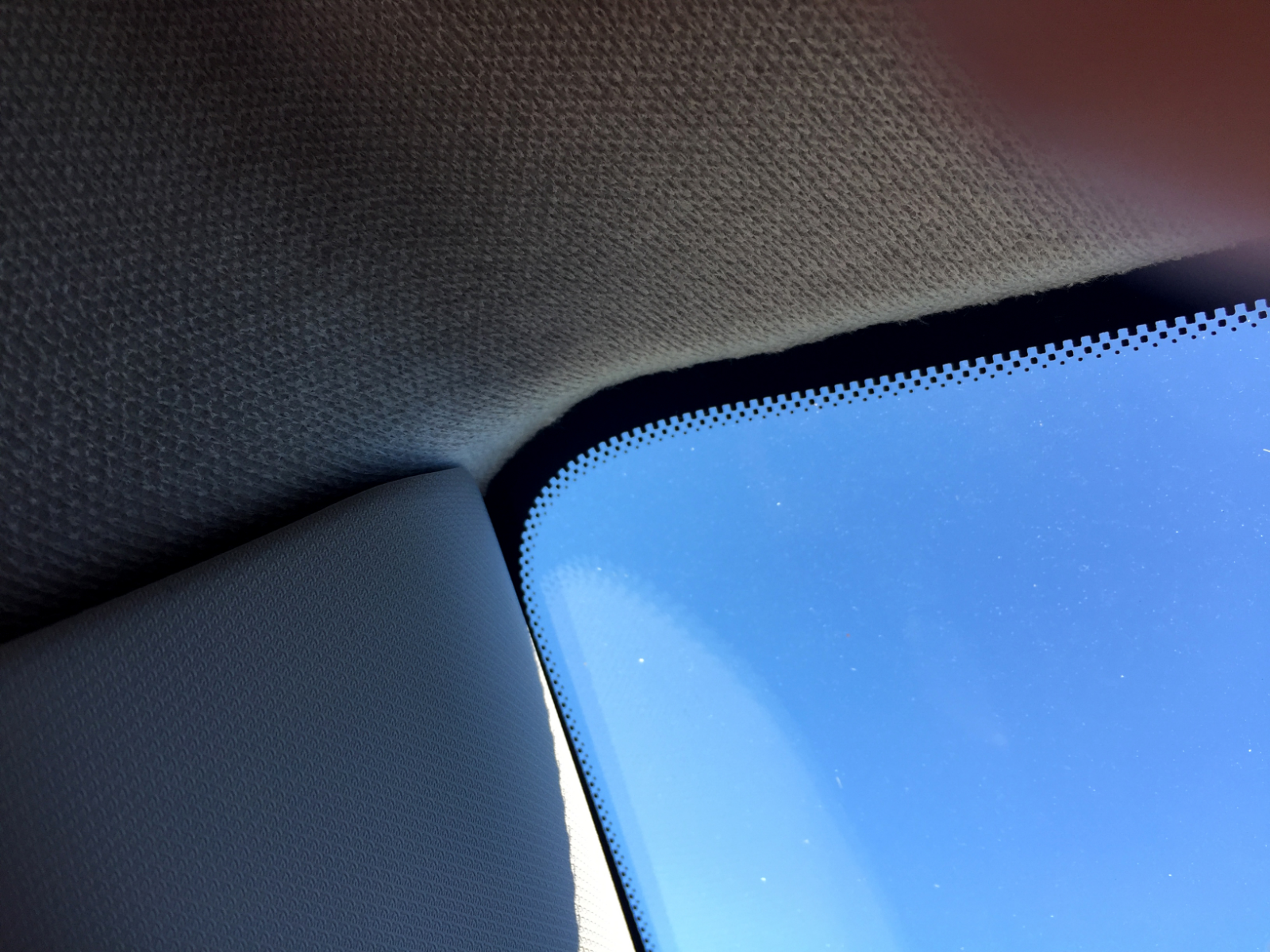

Next I used a small trim spatula tool to carefully prise the headlining down a fraction - just enough to hold the wire near the centre of the rear view mirror. Here I allowed enough cable to route around the shroud edge and to connect into the camera without any excess. Remember with this camera, you don't need to keep plugging and unplugging wires - the mount always stays on the windscreen and the camera is attached and detached magnetically.
Next, use trim removal tools to gently remove the end of the dash panel on the passenger side. There are clips that are quite tight all around the cover (I have marked these in cream arrows above). My advice is to work your way around gently and do not try and pull off completely from one direction or you will risk snapping the other clips. Be wary that you will need to lift part of the weather strip as the cover goes underneath this. When you have made progress lifting it partly away all the way around, I suggest pulling directly off from both sides at the same time. It will come off with some persistence - just don't yank it off.
Next use your Trim tool / spatula to gently recess the wire into the headlining back to the corner of the windscreen.
