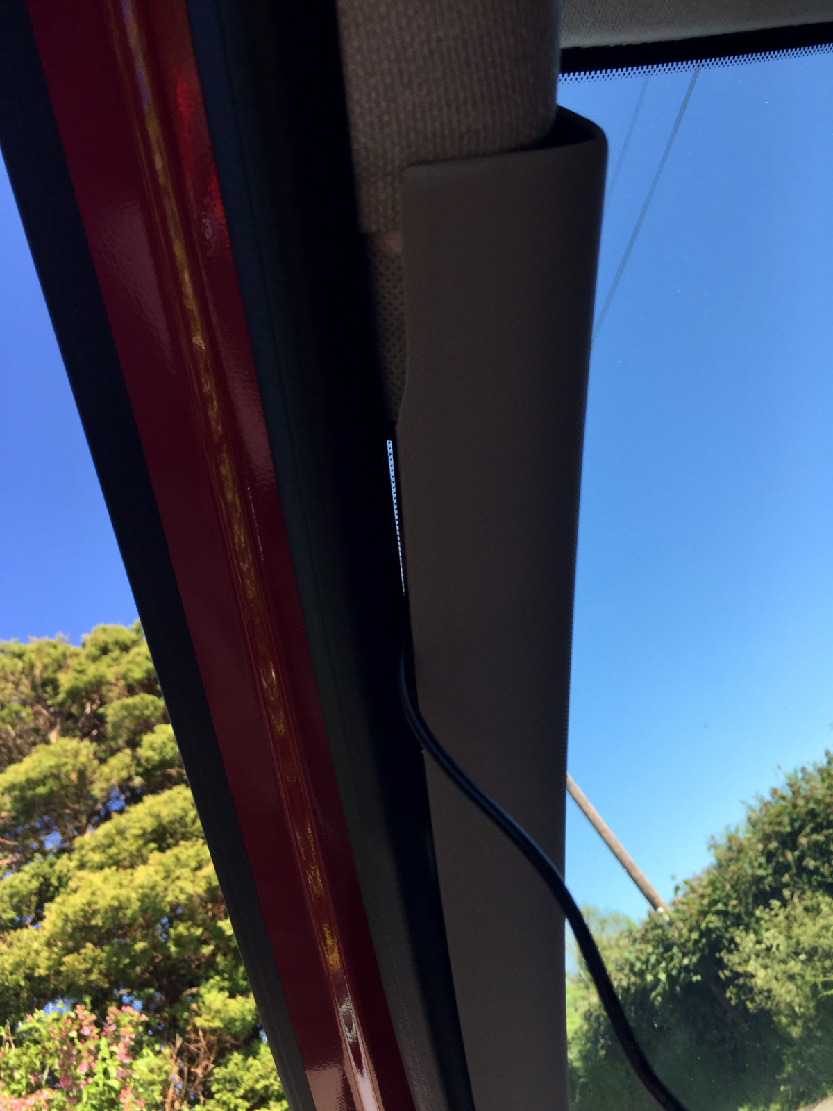

Next use your Trim tool / spatula to gently recess the wire into the headlining back to the corner of the windscreen.

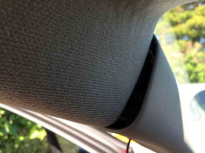

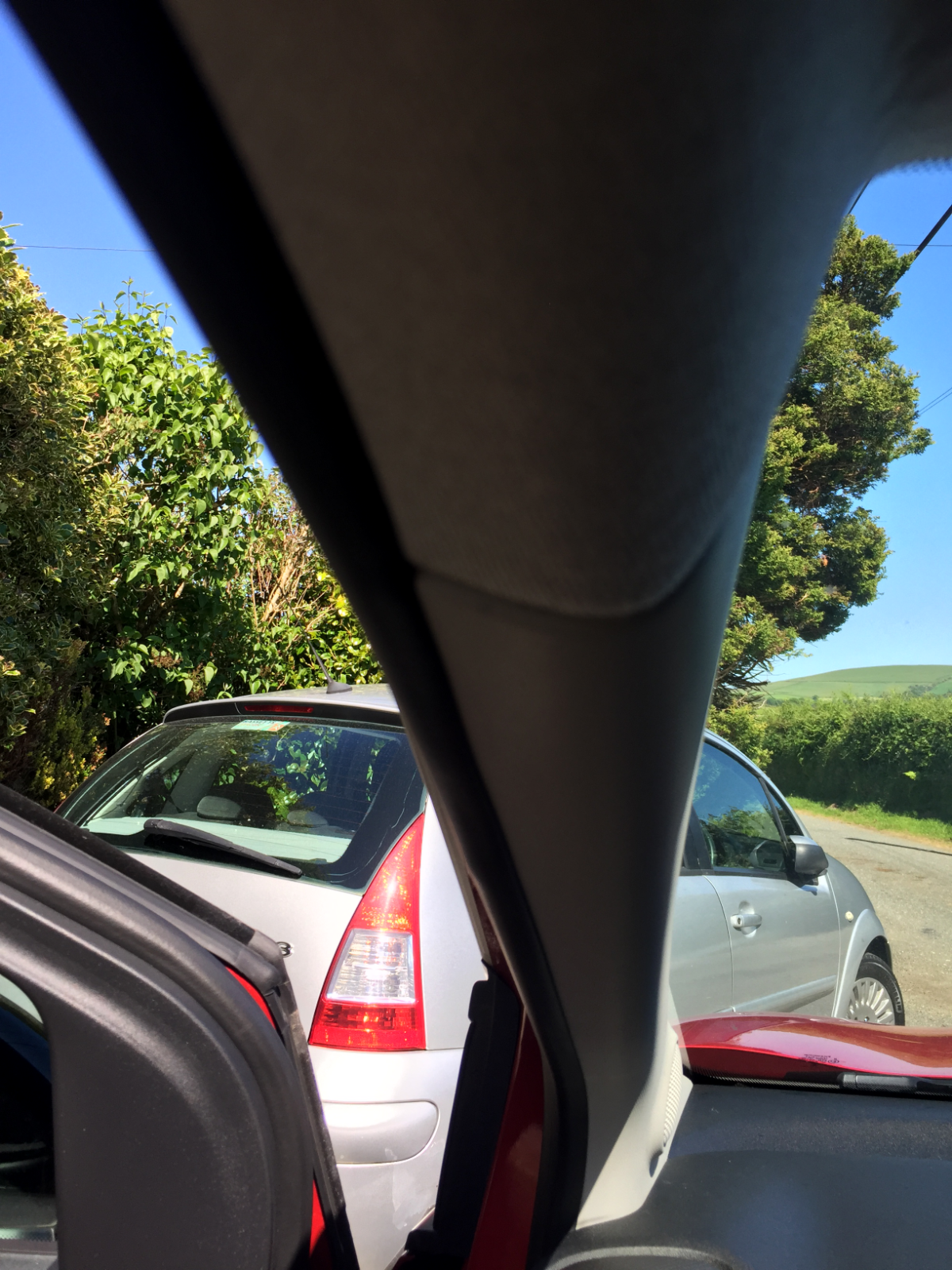

Now for the 'A' Pillar trim. There is no need to remove this fully - especially as the speakers are wired into the bottom of the trim. Just lift up the weather strip to get behind the top of the 'A' Pillar, and use a combination of a trim too, and your fingers to gently lift the top part away. Be very careful, as there is an airbag inside (especially when using a trim tool - do not go too deep)!
Gently prise the top part away. You can see just see the airbag in the picture above.
Feed the wire behind the airbag and out.
Route the wire from the corner of the headlining behind the airbag.
It is therefore important not to fix anything at the fusebox end before doing this part.
Now you can tuck the wire all the way down behind
the weather strip. Replace the 'A' Pillar Trim by gently
but firmly knocking it back.
Here the wire exits out of the Weather Strip
Near the Dashboard end panel.
A neat, tidy and safe job.

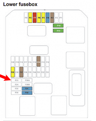

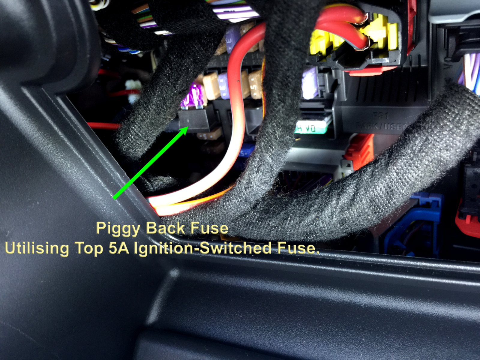

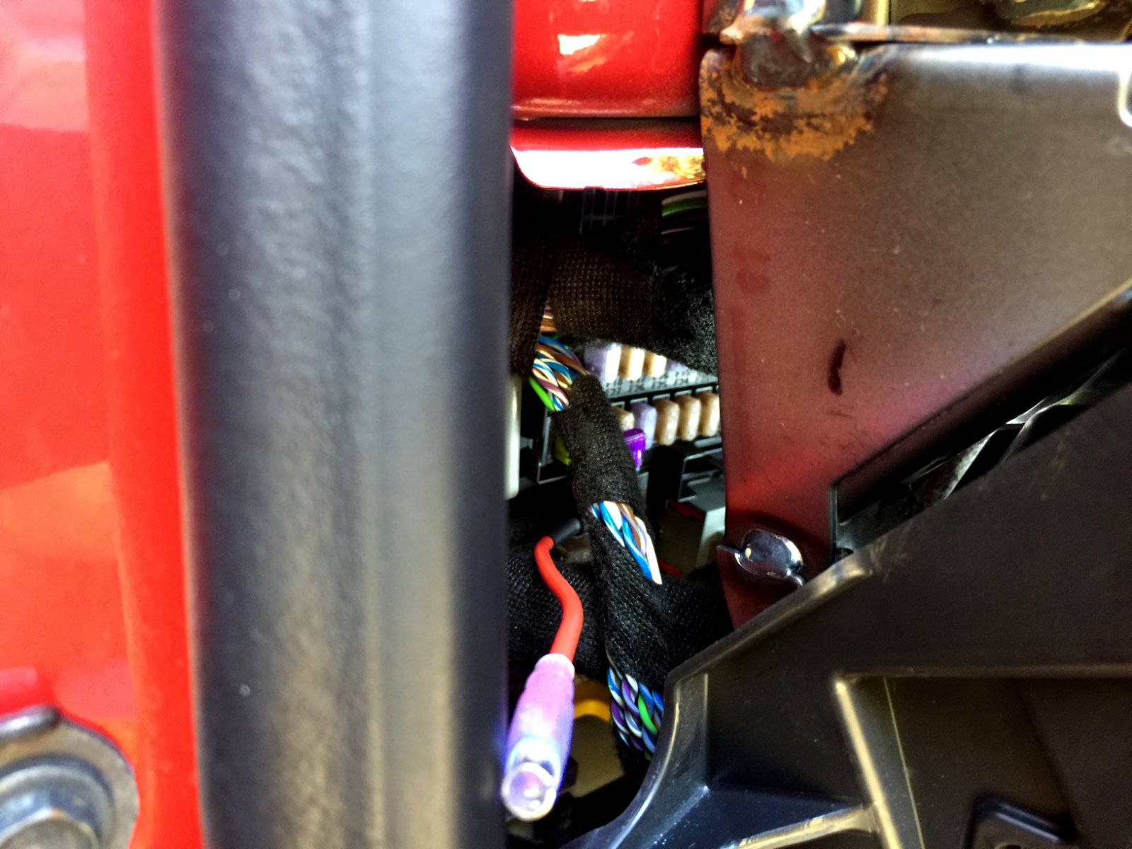

Next for the fuse. I used the top brown 5A fuse (Fuse number 33 on the above diagram)
I wanted an ignition-switched live for my camera, as I want it to go off with the ignition. Reason being, I always used to forget to turn the camera off and I don't want to run the car battery down. This Navitel camera has a battery that can power the camera back up in the event of a knock detected by the G Sensor in parking mode and will power the camera back down if it detects nothing after a configurable set time. So in my case that is adequate for my needs.
Remove Fuse F33 using some long nose pliers and insert it into the piggy back fuse holder from your hard wiring kit along with a suitable smaller fuse for your camera, and then re-insert the piggy back fuse into the fusebox.
All you need to do now is connect the live camera wire to the fuse holder live as shown above using bullet fixings or similar as supplied in your hard wire kit.
