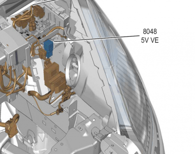

Re: C4 Picasso heater blower
BCP3 is the relay 3 protection switch unit
The Blower Relay (8048) is shown below:

Thank you mark I’ll look into that next I really appreciate this
x 6948
No worries, but your car only has the single Air conditioning system - different tot he other chap and diagram. You do have automatic additional heating though.
