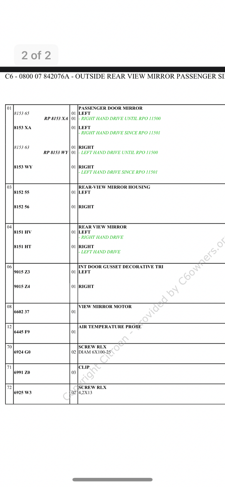

Check the main diagram out - Driver's side Diagram - and clearly shows the mirrors for LHD and RHD.
So unless I've completely mis-understood, I think the part is correct :chin:

This document on C6owners confuses the hell out of me too!

Looking at the C6owners document (which only shows the passenger side), I think this shows that although they label the mirrors for LHD and RHD, they are the same L/H and R/H side. Hence the confusion.
8151HT is the ridiculously priced mirror I need I think.

GiveMeABreak wrote: 18 Jun 2021, 18:40 Check the main diagram out - Driver's side Diagram - and clearly shows the mirrors for LHD and RHD.
hmm that's what it says.. very confused :lol:
