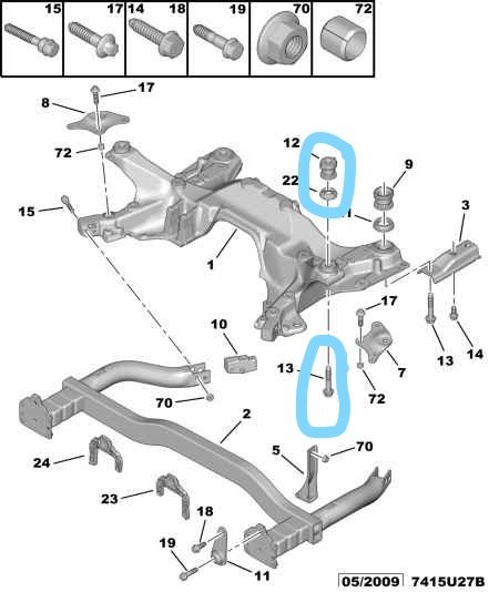

Hi All,
I,m trying to get a lay out for items 12 ,22 and 13 subframe to chassis fixings.
Anybody with knowledge.
Kenny

I will clarify why I'm asking the question.
On my C5, I have the bolt, nut and unsure if rubber bush (22) is present and rubber bush 12 are definitely missing.
Does no 22 fit into the sub frame arm or the mounting in the body work ?
If so I have both fitted.
Thoughts please.
Kenny
Thoughts please.
Kenny

Okay, I have solved this, for anybody's info
Part No 22 is fitted to the bottom of the subframe leg and part 12 is fitted to the top of subframe leg, the bolt passes through and fixes to the nut on the body work.
I suspect this should be a captive nut welded to bodywork as it is not listed as a part number.
Kenny
Kenny
