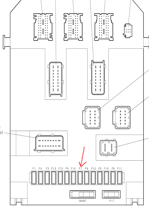

Ok, that helps, as you do, according to the VIN, have the ambient lighting pack and activated driver and passenger footwell lamps on this vehicle - leave it with me I'm checking some of the electrical connections out.....
Ok, so have a look at the bottom fuse (F7) in the lower row of the BSI in the passenger compartment glovebox arrowed in red. This is a 5Amp fuse for the map reading lights and the glovebox lighting and the vanity mirror lamp.

Fuse is good
Kev.
Fuse is good
Kev.
