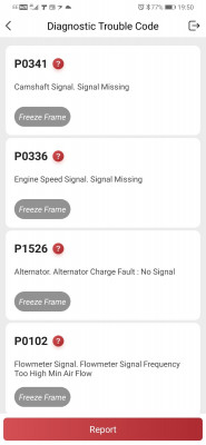

Strange after work I start the car and revving on neutral gear - no issues (going to 5000 with no problem) , wow I was more than happy but then when driving still have a bit at 4000 rpm but not that bad cause the gearbox change to the next gear
vasilus_rs
- Posts: 22
- Joined: 15 Jun 2021, 21:50
- x 2
Re: Citroen c5 x7 2.0hdi rpm issue
Just hold it little bit more in the problem range and those errors show up. But the car is driving fine before that rpm so could it be bad timing??
Hi guys just a quick update, issue is resolved the problem : CRANKSHAFT PICKUP SENSOR RING 0515T7. In case someone has the same problem
