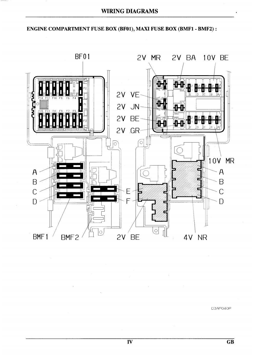

Can anyone provide the Xantia Phase 2 Fuse BOX Pinout Diagram? The Internal fuse box, labeled as BF00

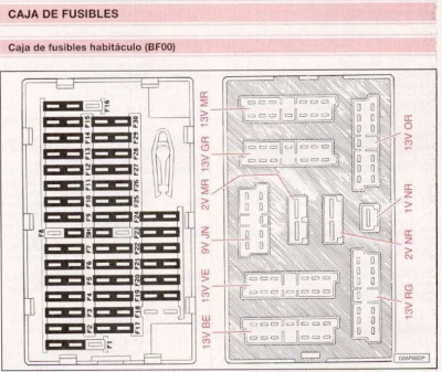

I´ve found this image, with the socket names. But No pinout diagram
My car is a Activa V6 Phase 2. I don´t know if the diagram should be specific for this model

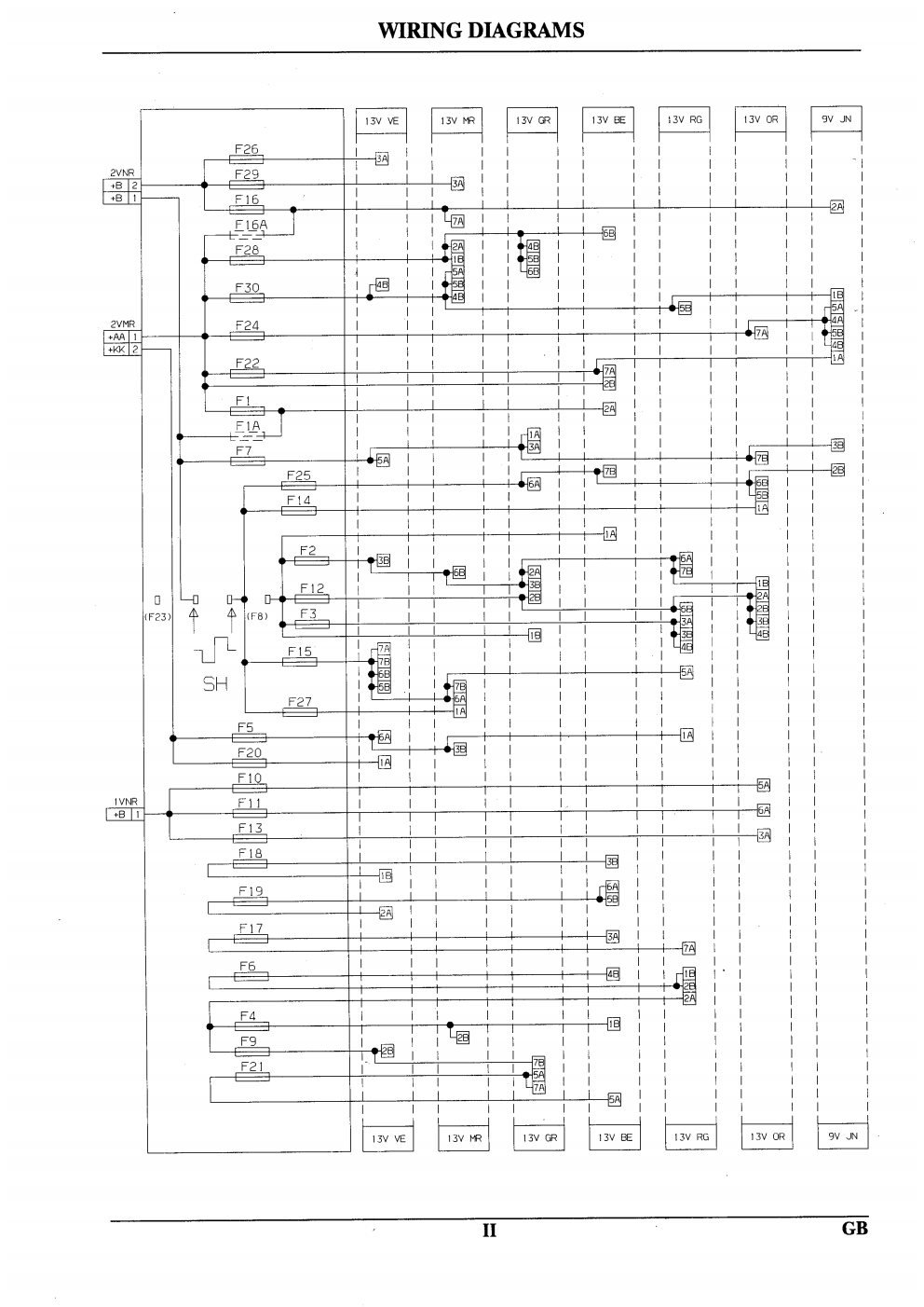

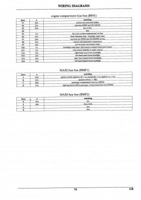

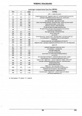

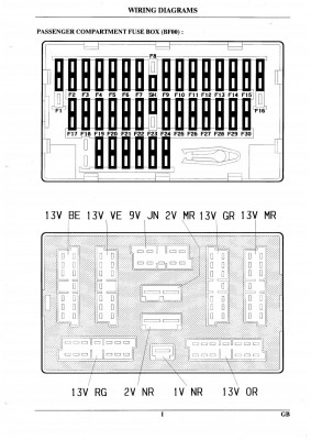

Renanek, Mike
I'll look out the circuit diagram/pinouts, using your production date above (RP=7681).
This is what we have...
Source - Electrical Wiring Diagram, Xantia ph2 (BRE0312 Vol.1 p.1)
?Click to enlarge Have included the other engine bay fusebox as well.
Hope helpful.

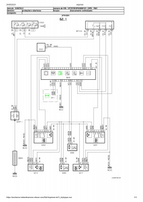

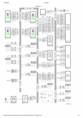

Re: Xantia Fuse Box Pinout Diagram (BF00)
xantia_v6 wrote: 11 Jun 2021, 20:01 If you tell us which circuit you are working with, we may be able to find a specific diagram.

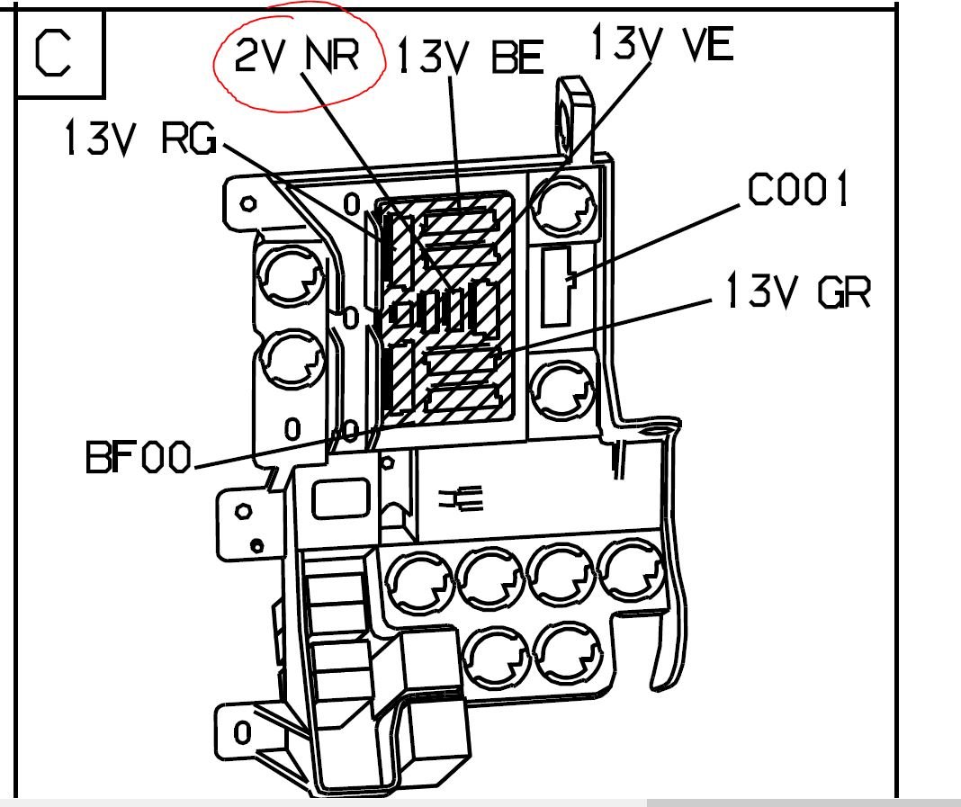

I´m trying to solve some wiring issue on my car. My Car is dead without key.
I dont know how to explain. No Central lock, no alarm, no radio or clock memory, no internal light. Nothing. Dead
After turning the key on, everything is up and runing perfect
That´s why i´ve asked for the BF00 (Internal fuse box) and the IC01 (the Bulkhead 133 pins connector). To find all the + received on the fuse box
I'm following the electrical diagram below to try to understand and I've already discarded some places that are working (f you can double check for me if they are right, please do)
I just notest that the 2v NR on this diagram is in wrong place, when compared to BF00 diagram that you sent to me.
I think this diagram was made with errors by citroen, lol. Here in detail

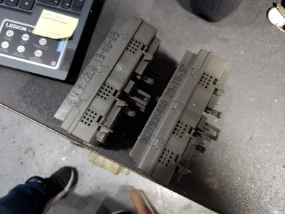

Hello! Solved... my car was using a XSARA fuse box. The battery pinout is different from Xantia´swhite exec wrote: 11 Jun 2021, 21:20 Has the fusebox SHUNT been checked that it is in correct position?
It is designed to kill all battery drain while the car is in long-term storage/shipment/pre-delivery.
See Passenger fusebox, item SH - to go between F8 and F23 for normal use.
9610352280 = Xsara
9627935480 = Xantia
Xantia Ph 2 Activa V6 - 7681CJ / VH000121
- x 1746
Result! Well done in tracking that down. Not something you'd think of...
