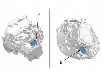

Re: 3008 cruise control not working 5th or 6th
Here you go:
"a" identification label.
"b" Location of engravement of serial no. and plate.
So 'a' should have the info you need, but getting a photo may be easier / useful while you are there.
Well I forgot to put my findings in here, it does appear to be the wrong gearbox.
Part number fitted is 9674157510 HL136
This seems to be an 20EA31 from what I can gather.
So I figured this was the reason behind the car not being able to work out wheel speed and therefore no cruise in 5th or 6th.
