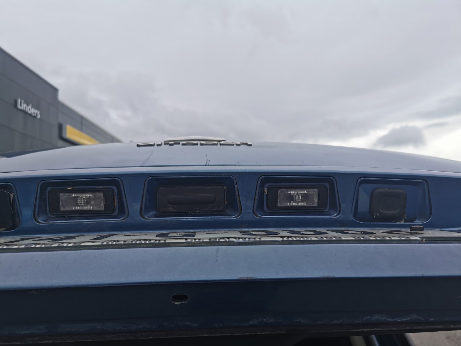

Hi, I've recently bought my first Citroen , a 2014 C4 grand Picasso Exclusive. I inadvertently pressed the second button on the boot . Nothing happened as I believe the window had not been opened in a long time and may be stuck closed. The problem is that the key fob now won't lock the doors as it did previously . ie the door mirrors don't move /retract . I'm afraid to try force the glass open in case it smashes , I also can't see any hinges or struts specifically for the window. When I now press the tailgate window release button, I can hear the locks actuating in the other doors. There's no notification on the dash to say that the rear window or door is open .
Occasionally the rear wiper also operates when I try lock the doors from the fob . I can't find any info regarding the operation of the tailgate window in the manual ,

It's the square button on the right in the photo

Isn't that a blanking plug for where the camera goes on vehicles with a reversing camera?

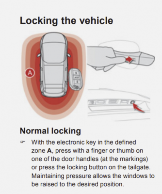

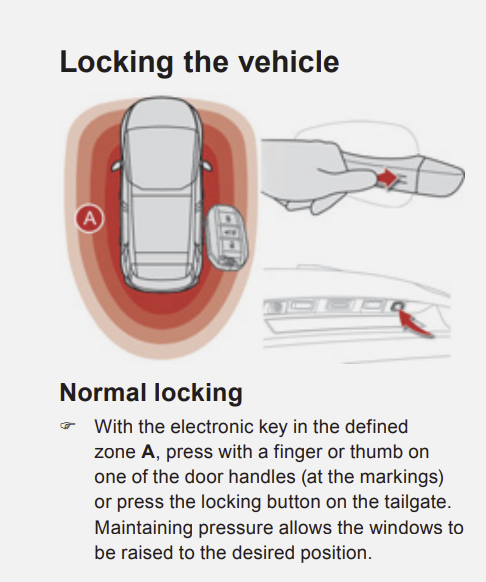

According to the manual that far right button is the unlocking / locking button.
- x 6956
Re: Rear Window C4 Grand Picasso Exclusive
Ok, I think I've got it. This model has 2 options - one, the button in the middle of the 2 number plate lights is for unlocking the electric tailgate / electronic lock.
The far right button is for versions fitted with the motorised tailgate. The far right button unlocks and raises or lowers and locks the tailgate.
Which you have depends on trim level, so if it does nothing, then assume you don't have a motorised tailgate.

That's it, it's definitely a button rather than a blank , and I can hear the locks operating when I press it , thanks GiveMeAbreak

hi no i have a 2017 with camera and motorised boot and also have that button on the right and it dont do anything so i think its a blank
