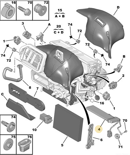

Afternoon everyone, I am looking for a wiring diagram on how the Electric heater Matrix connects to the car.
Details of car are CITROEN C5 2009 2.0 HDI DIESEL Make of ELECTRIC HEATER MATRIX is "BEHR G7192002"

There is no electrical connection to the heater 'Matrix' - are you referring to the passenger compartment air heating resistance module, shown as part (4)? The car heater 'matrix' supplies hot coolant for the main heating of the interior of the vehicle.
The Air Heating Resistance (4) is a supplementary air heating resistor to help with rapid demisting / defrosting of the windscreen on cold days and to help warm up the cabin until the engine gets to temperature.

Thanks Marc, thats just what I need, Can you provide how "(4) passenger compartment air heating resistance module" is wired please.

As for the wiring:
The passenger air heater element contains 3 resistive elements.
The resistive elements are Positive Temperature Coefficient (PTC) elements.
When it is commanded, the current passes through the resistance and causes heat to be released.
There is a black 4 way connector.
Pin 1: PTC 1 control
Pin 2: PTC 2 control
Pin 3: PTC 3 control
Pin 4: Earth
