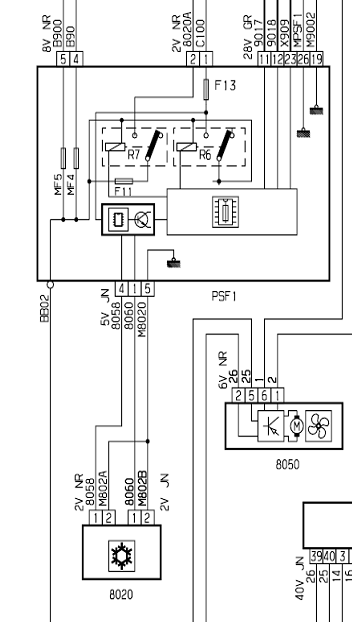

My C5's compressor wiring, the small 2 pin harness.
Anyone know of its function? A sensor?
It's female connector has a 10v reading.
No info in Haynes, or online. I'd like to know as I'm testing for a non working cooling fan.

seanrx wrote: 05 Jun 2021, 18:47 It does?
I have a Mk 2 car and compressor has also a yellow 3 pin plug.
Is this to clutch?
I've been watching a compressor/coil fix on YouTube. Can see a 3 and 2 pin.
8020 is the A/C Compressor on your vehicle. There are 2 connectors a 2 pin yellow and 2 pin black connector:
Wiring
Black connector:
8058: Compressor Valve Control
M802A: Earth
Yellow Connector:
8060: Compressor Control
M802B: Earth
Both go to the Engine Fuse Box (PSF1)

Re: AC Compressor wire 2 pin.
Unread post by ozvtr »
There will be two connectors on the compressor. One yellow and one black. The yellow one is for the clutch, the black is for the electrovalve. The electrovalve is on the "back end" of the compressor.
GiveMeABreak wrote: 06 Jun 2021, 07:17 Air conditioning compressor electrovalve
The externally-controlled air conditioning compressor has an electrovalve which permits regulation of the low pressure, which thus makes it possible to control the temperature of the evaporator to between 3°C and 13°C. Its purpose is to produce the quantity of cold air necessary for comfort and thus save fuel.
N.B.: When the air conditioning compressor is not clutched, the air conditioning compressor electrovalve is at 0%.
The air conditioning evaporator reference value is regulated between 3 and 13°C depending on the exterior conditions, the calculated passenger compartment temperature and the temperature reference values displayed.
In visibility mode, the air conditioning evaporator reference value is always 3°C.
Effectively the electrovalve controls how much Compressing the compressor does. It's more efficient than switching the clutch in and out to regulate the refrigerant.
If the cooling fan(s) stop working it's usually the electronic speed controller or the speed control resistor (in the fan unit). Depends on which system you have. If there is a failure of the engine ECU (the engine ECU controls the fans) or wiring, the fail-safe is that the fans run continuously. However the power for the fan(s) comes from the BSM!

The above info is specifically for the system on the OP's C5 with RFTA (regulated A/C) and the wiring diagram extract I put up 2 posts ago show the 2 connectors. This should cover the system's operation in enough detail. :)
Sorry, missed that. Was concentrating on OPs fan controller problem.
