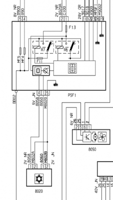

Re: AC Compressor wire 2 pin.
8020 is the A/C Compressor on your vehicle. There are 2 connectors a 2 pin yellow and 2 pin black connector:seanrx wrote: 05 Jun 2021, 18:47 It does?
I have a Mk 2 car and compressor has also a yellow 3 pin plug.
Is this to clutch?
I've been watching a compressor/coil fix on YouTube. Can see a 3 and 2 pin.
Wiring
Black connector:
8058: Compressor Valve Control
M802A: Earth
Yellow Connector:
8060: Compressor Control
M802B: Earth
Both go to the Engine Fuse Box (PSF1)

- Posts: 42019
- x 6955
Some further info on the A/C system on your vehicle as I had some time this morning - that may help with understanding the operation:
Management of the cooling compressor
Air conditioning compressor safety - Air conditioning evaporator icing safety function
To prevent icing up of the air conditioning evaporator, the BSI prohibits triggering of the air conditioning compressor in certain temperature conditions. The evaporator icing up safety function is managed by the BSI.
Cutting of the air conditioning compressor due to compressor speed
When the air conditioning compressor speed attains 8100 rpm the air conditioning compressor is cut off.
If the air conditioning compressor speed exceeds 7500 rpm for more than 10 seconds, the air conditioning compressor is cut off.
Air conditioning fluid pressure safety
The air conditioning high and low pressure safety management status is transmitted by the BSI via a linear pressure sensor.
The linear pressure sensor measures the pressure of the air conditioning fluid.
The reception of pressure information is carried out by the engine ECU through a wire link.
When the pressure of the air conditioning fluid is below 2,8 bar, the air conditioning compressor is cut off. The air conditioning compressor is triggered again when the air conditioning fluid pressure increases to above 3,3 bar.
When the pressure of the air conditioning fluid is greater than 28,2 bars, the air conditioning compressor is cut off. The air conditioning compressor is triggered again when the air conditioning fluid pressure falls below 20 bars.
Safety as a function of exterior temperature
When the exterior temperature is below 3,5°C, the air conditioning compressor is cut off.
The air conditioning compressor is triggered again when the exterior temperature increases to above 4,5°C.
Safety as a function of the electrical diagnosis
Management of the OFF times
The safety functions implemented in the BSI 1 are associated with air conditioning compressor cut-off OFF times. The air conditioning compressor cut-off times linked to these various safety functions are not cumulative.
The cut-off time is 5 seconds for all cut-offs, only the high pressure and icing up cut-offs have a duration of 150 seconds.
Air conditioning compressor electrovalve
The externally-controlled air conditioning compressor has an electrovalve which permits regulation of the low pressure, which thus makes it possible to control the temperature of the evaporator to between 3°C and 13°C. Its purpose is to produce the quantity of cold air necessary for comfort and thus save fuel.
N.B.: When the air conditioning compressor is not clutched, the air conditioning compressor electrovalve is at 0%.
The air conditioning evaporator reference value is regulated between 3 and 13°C depending on the exterior conditions, the calculated passenger compartment temperature and the temperature reference values displayed.
In visibility mode, the air conditioning evaporator reference value is always 3°C.
Regulation of the high pressure

There will be two connectors on the compressor. One yellow and one black. The yellow one is for the clutch, the black is for the electrovalve. The electrovalve is on the "back end" of the compressor.
If the cooling fan(s) stop working it's usually the electronic speed controller or the speed control resistor (in the fan unit). Depends on which system you have. If there is a failure of the engine ECU (the engine ECU controls the fans) or wiring, the fail-safe is that the fans run continuously. However the power for the fan(s) comes from the BSM!
Effectively the electrovalve controls how much Compressing the compressor does. It's more efficient than switching the clutch in and out to regulate the refrigerant.GiveMeABreak wrote: 06 Jun 2021, 07:17 Air conditioning compressor electrovalve

The above info is specifically for the system on the OP's C5 with RFTA (regulated A/C) and the wiring diagram extract I put up 2 posts ago show the 2 connectors. This should cover the system's operation in enough detail.

Sorry, missed that. Was concentrating on OPs fan controller problem.GiveMeABreak wrote: 06 Jun 2021, 06:39

Many thanks for your post. This confirms that I have an electrical fault.
A new t'stat is fitted, but no change in fan function.
I've been testing for continuity and that 2 pin plug is my final check once I find an old harness and wiring.
Also, my neighbor used his hi tec code reader on my car and found many 'intermittent' sensor/coherence/earth faults:
Ac, fan, thermistor, inlet manifold, cruise control. Its quite a list!
So I will do the basics first, strip and clean body ground points and multimeter check fuses, not just a visual check of them.
Am sure it won't fix everything, but I need a 'base' to work off.
