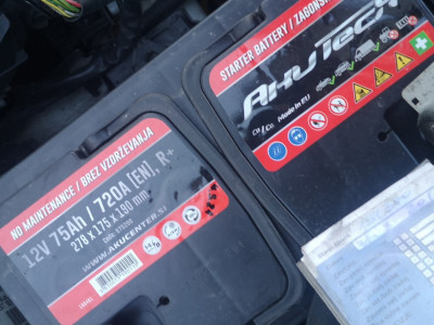

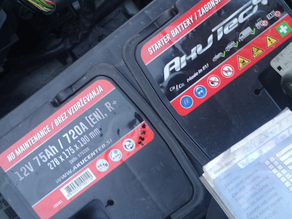

Good morning Marc.
The VIN of my C5 is VF7**************[VIN obfuscated, can be read by forum staff].
In the past I fitted 2 BOSCH S5 77 Wh/780A (BOSCH S5 0 092 S50 080). None of them lasted more than 3-4 years
What should I put in BSI for this new battery?
Regards.
Gregor

Put the one in nearest to what you have - but it should not be below a 720/70A battery.
Unfortunately European standards are a mess when it comes to battery codes - as they went from DIN numbers to ETN numbers and understanding the codes is often hopeless.
Just get the best battery you can for your cash, but I would avoid an AGM battery unless you have Stop Start.

I did have an AGM battery (Bosch S6) for a few years, but although they are good for starting the car very quickly, I wouldn't have another one as I wasn't greatly impressed with them after a few years. My current vehicle has Stop Start but uses an Enhanced Flooded Battery.
Your battery would be set as a L3 for this specification (in the Battery Charge Status Unit configuration).
